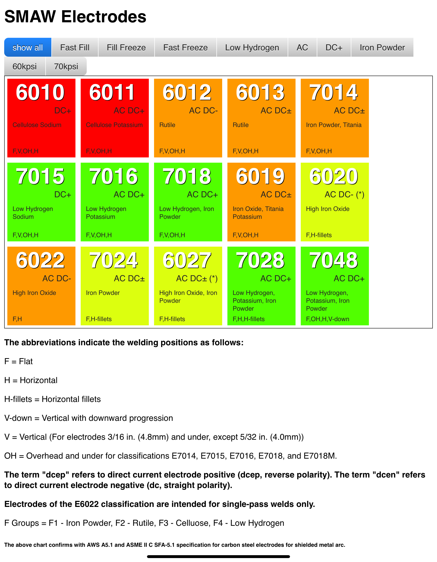

I have never used my welder for stick and I want to get one pound samples of E7018 and E6011 to try out.
I saw on a chart that these are for DC+.
What happens if you run these on DC- ?

You need to check the specs for the rods you buy.vdotmatrix wrote: ↑Mon Feb 10, 2025 8:28 am I have never used my welder for stick and I want to get one pound samples of E7018 and E6011 to try out.
- 6011 usually runs on AC or either polarity
- 7018 usually runs on DCEP but if used for a root pass, DCEN is suggested because penetration is less and there is less chance of blowing through.

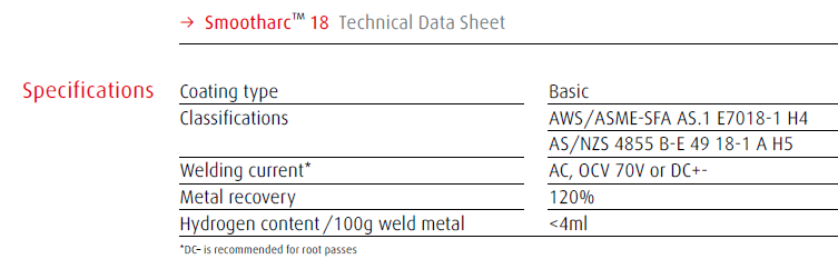

Tables of generalised electrode properties are a good indicator but the manufacturer's data is more accurate for a specific product.
On this 7018 data sheet,
The polarity is given as AC, DC+ or DC-. However, the note says that DC- is recommended for root passes.
- 7018.png (26.46 KiB) Viewed 14512 times
Jack

Thanks. I interested 6011 and 7018. My question is if you use other than the recommended electrode polarity, what will happen?Jack Ryan wrote: ↑Mon Feb 10, 2025 10:26 pm Tables of generalised electrode properties are a good indicator but the manufacturer's data is more accurate for a specific product.
Jack

As I said, for 7018, using DC- instead of DC+ gives less penetration. That is why it can be used for root passes.The polarity is given as AC, DC+ or DC-. However, the note says that DC- is recommended for root passes.
I don't use 6011 but as it is designed for AC or either DC polarity, it probably doesn't make much difference.

keep in mind it will vary depending on manufacture and also your machine.vdotmatrix wrote: ↑Mon Feb 10, 2025 11:18 pm
eg some machine won't run 6011 at all.
some rods say they will run but don't. some say they don't but can.
generally speaking running a rod on DC- it reduces heat and penetration. but some rods will run badly. eg some 7018's.
6013 can run very well on dc- and thats very useful on thin material. 7016's are commonly used on DC- for root passes for pipe (jody had video of that).
6011's i'm not sure on but i doubt you would want to.
Tweake I think you meant to say some lower end inverter type machines won’t run 6010. 6011 and 6013 are often recommended alternatives to that rod for these boxes.
Vdot, grab a pound of rods, try them on each polarity and see for yourself what the differences are. There is no substitute for live, field testing on your box with your hand to determine what works best.
