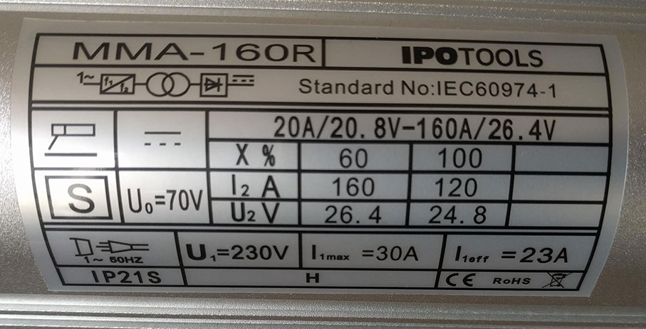

Just bought my first welder and I'm about to do my first welds, so absolute beginner here.
I went for a 160A AC stick welder.
I read as much as I could to avoid wasting anyone's time, but still have 2 things to doublecheck:
- The user manual says I can plug the clamp and electrode holder alternatively depending on the recommendations of the electrodes.
Does that mean I can use that AC device (that apparently can't do anything else than AC) for DCEP or DCEN?
- My first project will be to make a bike trailer arm out of a square bar of steel by cutting a V, fold it and weld it.
It's a 1 inch x 1 inch (2.5cm x 2.5cm) bar with 1.8mm "walls".
Which rod should I go for (number and diameter)?
Thanks
Technically you don't have an AC welder. Yes it has AC input, but it doesn't have AC output. Your machine outputs DC current and the polarity is selected by the way you connect the work clamp and the electrode holder. The rods I would recommend for that welder are 6011, 6013, 7018 and 7014. 6011, 6013 and 7014 are technically AC rods but they run fine on DC. 6010 is a DC rod but won't run on most inverters.

Hi mate, yeah that looks like a dc output. I usually use 7014s for structural, as they are all positional and leave good welds. Slag releases easy too. You may need to clean that steel up a bit. Just a side note if you use a wire wheel wear safety glasses and a face shield, and dont let people not wearing the gear stand around, those things throw wire spears. Just so you know
Just so you know, that symbol next to the stickwelder symbol. The full line with a dash line under it. That is a direct current symbol. A wavy line would be an AC symbol and theres not one on it so it must be full DC.

That thing is tiny! like my Tooliom 135S stick welder. It will probably only put out around 120A actual measured welding current though. It should be able to run 6011, but that will dig in too much on 1.8mm wall tubing, IMO. 6013/7018/7014 would be the rods to try.

rods, 6013 is common as mud and will run on anything. there is a trap with them so its not to easy.
a good rod for thin wall tubing as you can run them on negative and reduce blow through.
but pay attention to the rods description as there is tons of different 6013 rods available.
2.5mm mate. You will want to be in the 60 - 95 amp range. as Tweake said start with beads. Get some scrap and go about 70amps to start and go 5 amps up or down depending on whether it's too hot or too 'cold'.
You could go 3.2mm sticks but 2.5mm will be fine. Anyways the package should have the amp ranges, no matter what sticks you use get your settings on scrap metal tuned in, starting the middle of suggested range and go up or down depending on your machine. Miller welds and lincoln electric have some pretty good pdf's on their webpages. They are very useful and I use them frequently to get apprentices up to speed. Please post photos of Trailer set up when your done.
