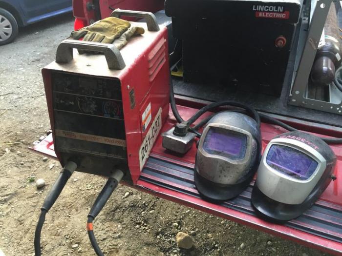

Would be interested to know what Lincoln and SG you had and why you didn't like it. I looked at the Lincoln 3350 series, supposed to be their top of the line.
I tried a 3350, I didn't care for the yellowish tint. I lit up on my 3G mig and could hardly see a thing. Had to stop and get a different helmet.LtBadd wrote:I'm in the hunt for a new hood, have a Digital Elite from like 10 years ago, looking at the new Miller Infinity or a Spesdglas, they have a new model coming out.AKweldshop wrote:I've used 3 of them.
Decent for Tig, nothing much for everything else.
I'll be trying a Yellow Jackson Balder soon, I'll see if its any good.
I don't like Lincoln or Speedglas helmets either.
But, that's just my seriously unqualified opinion.
Speed glass was a 9002x and a 9100x. Green is a horrible color for seeing anything. Imo
Headgear is nothing special.
I'm sticking to my pipeliner and Arcone lens, and my Jackson boss. Amber gold is my color.
Remember this is just my opinion.
