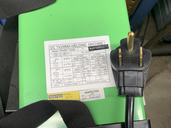

As Oscar stated in the other thread, I am not an electrical engineer, so maybe you can help both of us out here. ;)
I'm really not familiar with small conductor correction, so I just googled to find this link:
https://www.ecmag.com/section/codes-sta ... rs-part-vi
They show 2 different ratings, one for 167 degrees F. and another for 192 degrees F.
The rating for 12 ga for the 192 degree F connectors shows 30 amps. Maybe that's ok for the Primeweld as rbaldie said that is what is on the Primeweld. Are the molded plugs rated higher than a normal plug?
My Everlast green weenie says it complies to IEC60974-1 which is a welding standard. But I'm not clear what category the wire/plug falls into. Do you know? I haven't had any issues, my machine requires 27 amps and I run it on a 30 amp circuit. I don't know exactly what the Primeweld requires, I've seen reference to people using a 30 amp circuit online, but that doesn't mean that is what the machine is actually rated for.

The small conductor correction is for the branch circuit, not the extension cord on the machine. This is found in the electrical code book NFPA70 table 310.16 formerly 310.15(b)16 formerly 310.16........
... lol...... lol. Sorry im losing my mind with code changes.
Manufacturers need to have their equipment listed. UL being the most recognizable. Whatever the manufacturer recommends becomes the minimum.
So if chinas best is ul listed to run on 18 gauge then that is ok. Of course UL is reliable so they would not, but it would not be the first time a company printed UL stickers:(
If the company says you need 6awg for 20amps that is the minimum!
I ran into this with kohler generator. (I'm a kohler dealer)
Nfpa54 states what gas pipe size to use, but kohler has a recommended chart that requires larger pipe size for certain scenarios. I am required by the inspector to follow the kohler chart.
Back to the branch circuit temp rating.
There are multiple layers to temperature correction but the first step is to start in the right column in table 310.16.
You take the lowest rated piece and go with that. The 90C column is almost never used. Breakers are usually 75C. Romex is 90C but states that you must use the 60C column for ampacity.........what!!!!!!...... lol..... crazy lol...
Then we come to the small wire rule. If you have a 75c breaker with 10awg thhn (90C) in a conduit, running through a cool basement you still can't use the 75c column because of the small wire rule..... unless it falls into an exception for specific equipment.
And then you temperature correct for number of conductors in a conduit.
Oops, i forgot, table 310.16 is based on an ambient air temp of 86°f. So if ambient temp is higher make sure to correct.
At the end of the day it's all about heat dissipation. ......and voltage drop ....
You can understand why some guys throw their hands up and just upsize the wire. Lol

Simclardy wrote:The small conductor correction is for the branch circuit, not the extension cord on the machine. This is found in the electrical code book NFPA70 table 310.16 formerly 310.15(b)16 formerly 310.16........
Geez, I completely understand, with all the various codes it's very confusing at minimum.
Simclardy wrote:So if chinas best is ul listed to run on 18 gauge then that is ok. Of course UL is reliable so they would not, but it would not be the first time a company printed UL stickers:(
Hopefully a company as broadly exposed as Everlast wouldn't do something like that, but I wouldn't put my trust in them, not after how they treated me. :roll: The thing I can't see is the actual wire, and of course there's no marking on the outside of the cover for the cord the plug attached to the machine. I will figure it's ok, as I am guessing the Primeweld is also. Seems from what rbaldie said, his is marked 12ga.
Simclardy wrote:I ran into this with kohler generator. (I'm a kohler dealer)
I need to wire up a Phase Perfect that requires 100amps, does that mean I will need to use 1 AWG or will 2 AWG do for that? I only need to run a short distance, from the main panel to the converter which I will be putting on the wall next to it. According to the charts I'm seeing, 75C will take 2 AWG up to 115 amps, but 60C is 95 amps.
Simclardy wrote:Then we come to the small wire rule. If you have a 75c breaker with 10awg thhn (90C) in a conduit, running through a cool basement you still can't use the 75c column because of the small wire rule..... unless it falls into an exception for specific equipment.
For clarity, my new shop will be in a full walkout basement (overlooking a lake! :D), but it will be finished inside with finished walls and insulation. Does that fall under what you call a "cool basement"? I always thought it would be cool to have a shop overlooking a lake...but I think you're talking about a different type of cool! ;)
Simclardy wrote:You can understand why some guys throw their hands up and just upsize the wire. Lol
Indeed I can. ;)
In my shop I keep everything at 10ga for my 30 amp circuit. That goes for machine connected to the circuit as well as the circuit itself. I was mostly worried about the plug on the actual machine itself. My extension that goes into my 30 amp single phase uses L6 twist lock, and my extension for single phase has the same connectors and then I have a pig tail on the end with a NEMA 6R for the welding NEMA 6P my welder has. The wire is all SOOW up to the welder plug, have no idea what that is because as I said, no markings on it. I'm gonna figure that UL means they got it approved and that the wire inside the cover is correct no matter how thin the overall wire looks. I was comparing mine to SOOW which is thicker with more insulation as I understand it. The plug cord is more like romax.
Thanks for explaining all this, was very helpful for me and some things I've pondered for some time. It's not easy to get welders wired up properly when they put L6Ps on all of them, no matter how many amps they require. Hopefully that helps rbaldie in case I worried him about the 12 gauge plug (I doubt).

by TraditionalToolworks
Simclardy wrote:Keep in mind the chart you refer to for derating, 630.11(A), can only be used IF the unit does not have I eff stated. I eff is taking duty cycle into consideration already.
Sim,
So riddle me this...what is the difference between the I eff and I max? On my green weenie these numbers are very close, but on the HTP they are quite different. I know the max is what it can ultimately draw, and isn't the effective current, is that what is typically used when the machine is running most of the time?
I apologize if you have answered this before, you may have.
Re: Primeweld TIG 225x Review/Discussion
Posted: Mon Apr 06, 2020 10:54 am
by Oscar
Sim,
TTW, here is my take on it after analyzing the equation for Ieff given by the NEC 2011.
Summary: Ieff is an amperage number/calculation that effectively allows for the de-rating of the conductors based directly and almost completely determined by the duty cycle of the machine (in small part is the no-load idle current). The lower the duty cycle of the the machine, the more "de-rating" can be done and thus reduces the minimum required conductor sizes. Similarly, the higher the duty cycle of the machine, the less "de-rating" can be done and the larger the required conductor sizes must be relative to I1max.
Here is the plot of Ieff vs Duty cycle, using I1max=32A, and Io=1.3A. (open image in new tab).
As you can see, even though my HTP 221 draws 32A as a maximum, the fact that it has a 20% duty cycle, generates an effective amperage draw of ~14A or so. It doesn't have much to do with what the machine is actually pulling, for it is indeed pulling 32A. What it does mean is that it permits de-rating of the conductors to the equivalent of what would be needed for 14A as an absolute bare minimum, not as an ideal suggestion! For a welder that has 100% duty cycle, then the Ieff curve indeed does give the I1max value as the output, meaning no derating is possible for the conductors will not have time to cool off.
In fact, if I were to set I1max to 100A, the Ieff curve in the graph I posted, is pretty much identical to the chart in the NEC 2011 630.11(A) that gives multipliers for conductor sizes based on duty cycle on the non-motor generator column. ;)
Posted: Mon Apr 06, 2020 2:39 pm
Oscar,
But the problem is we don't really know what the duty cycle is for the rating on the machine, or am I missing something? Same for I-max, I was curious about that last night. Jeff Noland say that I-max is for the max draw for stick welding which is higher than tig, but there is nothing to implies such and/or how the duty cycle is calculated for either.
Same on my green weenie, I have no idea how it was calculated, could be some of the Chinese "new math". :lol:
You would think that everyone going through UL approval would use the same calculations, but from what Simclardy mentioned that is not so. There seems to be some onus on the manufacture to provide good data.
