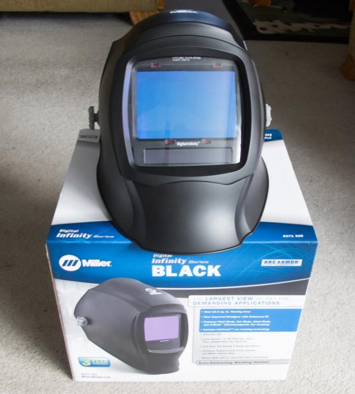

This will be a review in progress, the hood was delivered today (12/22) and I don't go back to work until 1/04/2016 (yea)
Purchased from Welding Supplies From IOC on 12/12/15 for $263 minus a $15 discount (I think it was for signing up for their newsletter, I had just created an account so maybe that was the reason, either way...). Plus I'll be taking advantage of Miller's $45 MIR (which can actually be emailed) for a final cost of $203!
I wasn't in hurry so I selected the free shipping option, only to be surprised they sent it USPS 2 day priority! However I wasn't surprised when it didn't arrive on the 18th as the tracking suggested.
My current hood is the Digital Elite which is at least 10 years old, so I am looking forward to seeing what the best Miller hood has to offer. I've been reviewing hoods on and off for the past 6 months and it came down to this one or the new Speedglas XXi. With the discount and Miller's rebate I figured for the price I couldn't do better.
I'll continue with photos and my impressions over the holiday's, and a final after I get some arc time with it.

The headgear seems quite good once it is adjusted, and has the most options in any hood that I've owned, the 10yo Digital Elite was my first auto darkening hood. After I use the hood I'm guessing there may be a final adjustment.
The lens has an arc timer, clock, timer, alarm, language and help functions, most of which doesn't interest me but some will find it useful. The lens does have an On and Auto On function that I like, my DE "on button" was getting to be a PITA to work.
- IMG_1679a.jpg (69.64 KiB) Viewed 2857 times
