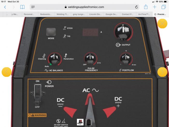

Given this is the one machine I've got seat time with, an observation... I wish the pulse range started lower. It's minimum seems to be a 2-second cycle (1 second high, 1 second low). Being able to adjust the ratios (timing and current) for high vs low would be useful, but that's not happening on a machine with 4 knobs.
FWIW,
FWIW,
Richard,RichardH wrote:Given this is the one machine I've got seat time with, an observation... I wish the pulse range started lower. It's minimum seems to be a 2-second cycle (1 second high, 1 second low). Being able to adjust the ratios (timing and current) for high vs low would be useful, but that's not happening on a machine with 4 knobs.
FWIW,
The latest rendition (purchased mine in 2011) of the PT-225 has a Pulse Range that is manually adjustable from 0.1 Hz to 20.0 Hz (as stated in the manual and on the front panel of the welder). Converting these values to time (1/Frequency), the range is 10.0 Seconds to 0.050 Seconds (50 milliseconds). I consider the range of >3.0 seconds up to 10.0 seconds to provide more of a stitch-weld effect. There are a few things about the pulse spectrum that we do not know, for example: Pulse Width (PW in time, end of the pulse leading edge to the beginning of the pulse trailing edge) is not mentioned so we must assume this pulse spectrum has a 50% duty-cycle; Pulse Repetition Interval (PRI in time, 50% point of the pulse rise time to the 50% point of the pulse fall time) is not mentioned so we must assume (once again) that the pulse spectrum has a 50% duty-cycle. Adjusting the amplitude individually (on the positive and negative portion of the pulse waveform) could help in critical/unique weld applications.
Have you used the AC Balance much? This function can be set to Automatic, where the PT-225 automatically adjusts the balance based on the amount of current you are welding with. This function can also be manually adjusted for Electrode Positive in the range of ~20% to ~60%, and for Electrode Negative in the range of ~25% to ~80%.

To whomever is interested:
Lincoln Precision TIG 225, AC Balance, balanced EP vs EN Vernier Control, in the time domain. Rotary Scale to Linear Scale in percent, for the EP Time On to the EN Time On, of the square wave.
1 | 2 | 3 | 4 | 5 | 6
20 30 40 50 60
80 70 60 50 40 30 25
EP, Electrode Positive in the range of ~20% to ~60%
EN, Electrode Negative in the range of ~25% to ~80%
These limit values are absolutely a rough estimate, it is difficult to determine the actual ratio between EP and EN based on the front panel demarcation. To determine the approximate values of the demarcation, for any specific Welder, one must test the Welder response to the AC Balance adjustments through observation of the weldment, especially the surface etched zone and penetration of the bead. There are adjustment effects below and above the major divisions as shown on the front panel. I believe only Lincoln Electric can answer the question, what is the sensitivity (delta change) of this control.
20 30 40 50 60
