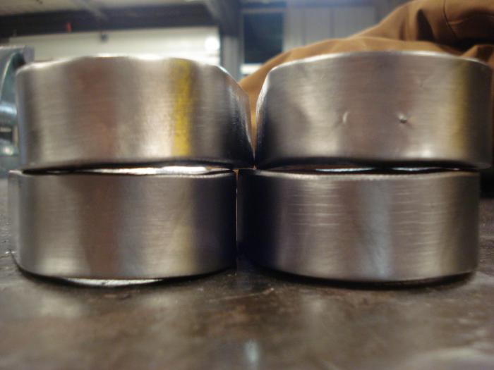

Any criticisms? The one piece has slag inclusion. I used a wire wheel to clean up my weld, next time I will run a grinder down the toe of the welds. The one piece that looks undercut is. I will probably weld up three more test pieces and if they go well then do one for a certification. Hopefully tomorrow I can get macro etch pictures on here.
- DSC07929.JPG (34.47 KiB) Viewed 9367 times
- DSC07928.JPG (31.07 KiB) Viewed 9367 times
- DSC07917.JPG (66.37 KiB) Viewed 9367 times
- DSC07916.JPG (68.32 KiB) Viewed 9367 times
OH MAN!!!
Please don't weave that wide.
Agreed to large of an area to weave, stringers will be more consistent IMO.AKweldshop wrote:OH MAN!!!![]()
There are several reasons that weaving wide like that can be bad. The first two are slag inclusions and lack of fusion. It looks like that is what happened in your bend tests. Another reason is the code you are welding to and/or the WPS by a given company or customer. I would recommend trying stringers.
However, technically you can weave as wide as you want to as long as you can prove it will pass. There is technically nothing we can say against a wide weave if you pass your bend tests repeatedly.

Just as a rule of thumb (and I don't recall whether this was from AWS D1.1 for materials of 3/4"+, another code, or an anecdote from a weld inspector), you should never weave to produce wider than a 5/8" bead. That would mean stacking weaves, and the cap would be two weaves rather than a single wide weave in your example.
There's much more control in keeping a smaller weave, which is why stringers are often preferred. In a WPS, it may state "stringers" with occilation permitted. Occilation is a slight weave that broadens the puddle, but does not leave "tracks" as evidence of weaving.
Agreed. That weave is way too wide. Try splitting that into two smaller weaves and weave faster. It appears that your weave was very slow and that can allow your slag to freeze. Once the slag freezes you run the risk of trapping it in your weld when you run back over it. I will also caution you about running a grinder down the toes of your weld. It can create a groove that has a high depth to width ratio which can create problems with slag inclusions and incomplete fusion. Instead of holding a 90 degree work angle while weaving, try twisting your wrist from left to right as you progress up the plate. This will give you a much smoother transition between the weld and base metal. You want a slightly concave fill pass so that there is no void between base and weld metal. This void is what is trapping slag in your coupons. \

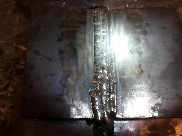

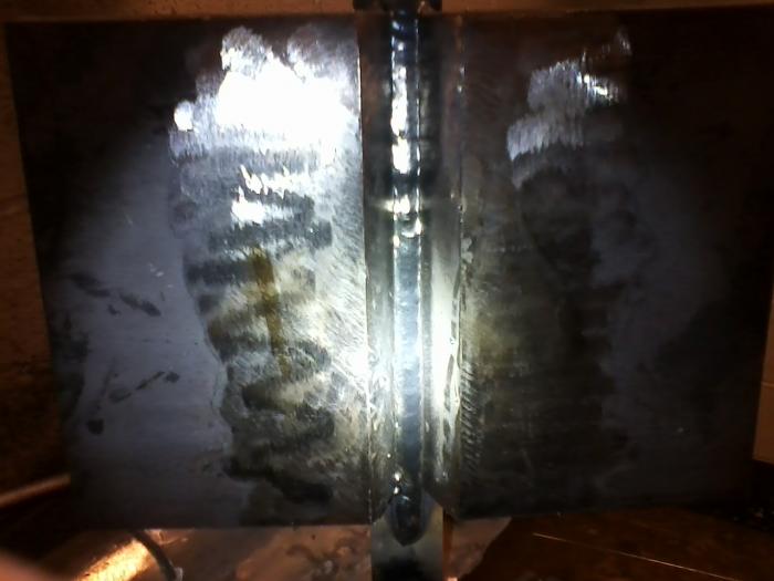

I went and preheated the test piece to around 250 degrees, which I hadn't done prior. I noticed no matter how dialed in I felt I had the machine the first weld I layed always had slag that couldn't be easily chipped off. This time there was a slight peeling to the slag of the first weld. The more I filled in the piece the more of a peel I had to the slag. Instead of weaving the root pass I ran a single fat stringer. I was pretty pleased with it minus one hiccup in it which I ground out. I ground on every weld and feel very confident I did well. I ran this around 375 IPM and started at 24 V and bumped it up to 24.5 V after a few passes. When I mig weld I can set the same machine to the same settings and it welds exactly like I expect it to. With this stuff it seems like I use a different setting every time.
My test piece is oversize so I will trim the ends off. Doing this on the last piece saved me from sending in what would have been a failure. The school pays for 3 certification tests, after that we pay for our own. I have a very minor amount of undercut that you really have to look close at to see it is there. I was worried about undercut on my previous piece and measured it and most of it was a 1/64" with none at the limit of 1/32", this is much less. That and I am over the 1/8" limit on cover pass height so I will grind that down also. It seems like I have been on this test for an long time and am ready to move on.
Pictures are of the root pass and finished product. Any criticism is welcome.
