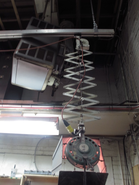

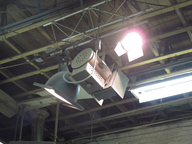

Heres some pictures of the lighting setup I did in my area. All the lighting is controlled by dimmers that i can adjust however I needthem.
Top Picture....I rigged up some lighting trusses to the ceiling truss all around my area and hung some 500 watt floodlights along with some older 500 watt t.v. lights to get a nice even light from any side of what I'm working on. We had a bunch of high-output flourescent lights already in the area, but these give the whole area a nice boost. It's much easier to see what I'm doing. Also, the combination of flourescent and incandescent lighting is much closer to the daylight spectrum than either alone.
Middle Picture.....A 1K pancake light gives ample coverage by the lathe. The light is attatched to a pantograph which can raise or lower the light as need be. The cross bars in the pantograph work like a scissors lift and the lighting fixture acts as the counterweight so it stays in whatever position I put it in.
Bottom Picture.....The pantograph is hung from a traveller track so I can slide the whole thing from over the lathe to over the mill if I need it over there.
Steve
