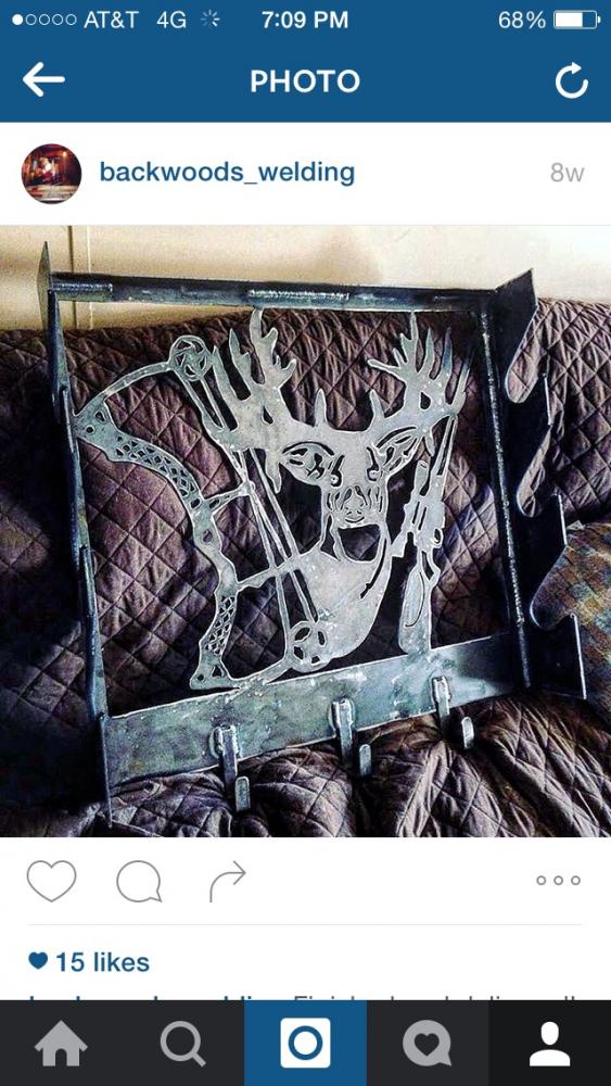

Well either are effective. I have both in my shop, I specialize in hand cut metal art with a plasma cutter but I broke the torch head on my machine in the middle of a big order so I had to resort to the oxy torch. I use the oxy primarily for heating metal and cutting thick metal or for portable cutting where there isn't power. Plasma is great for cutting any type of metal and making precise cuts. Both are great I can't choose one over another because they both are equally valuable.
- Plasma 1/8" thick
- image.jpg (103.98 KiB) Viewed 3536 times
