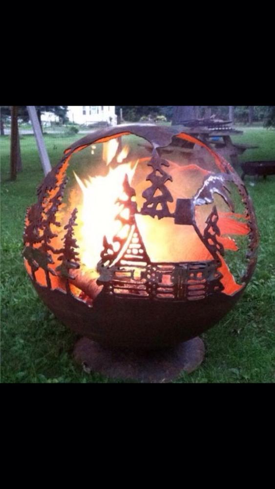

I do hand cut metal art with plasma and I am running an Everlast Power Plasma 50 and love it. I cut stuff from 22 gauge to 1/2" no problem. It is dual voltage and cost $800ish (had it for a couple years haven't priced it lately) I use it every day without problems. Great machine!
- 3/16" wall fire pit
- image.jpg (52.82 KiB) Viewed 4820 times
- Fire ring out of 14 gauge
- image.jpg (55.03 KiB) Viewed 4820 times
