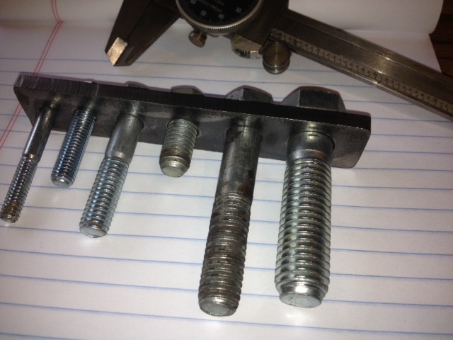

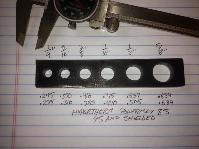

Keep in mind that there are many different technologies with plasma cutters. There are older technology systems that never cut a straight edge, there are some very low cost imports that cut decent with a new set of consumables...but the consumables wear rather rapidly, affecting edge quality. There are major brand units (and yes you have to pay more for them) that have some nice torch and consumable technology....even in an air plasma (high definition plasma is another animal altogether!) that can produce excellent cut edge angularity, excellent hole quality and incredibly long consumable life (thousands of feet of cut and 800 to 2000 starts on a single set of consumables). Here are a few pictures of hole quality in 1/4" steel as well as edge smoothness and angularity on 3/8" steel, all cut in my home shop on a low cost cnc machine.
The middle picture shows approx. top and bottom dimensions on holes...showing the taper. The last one is as cut 3/8" steel cut at 45 amps with a Powermax plasma.

Yes....Since I have worked for one company for 37 years I certainly have more info stored in my brain about the products made there. I do have experience with most brands...however if I posted pictures of the cuts from other brands that certainly could be mis-construed as well. I actually have 3 cnc machines in my home shop that were bought and paid for by me and are used for hobby type work as well as occasional paying jobs. I use them online on forums to help those that have similar low cost cnc machines and need help with improving cut quality, regardless of the plasma brand. The pictures I show will pretty much always be using the Hypertherm units that are on my machines, and the cuts will be done at "book specs".....no trickery. If there is dross, slag, taper, it will be in the picture. My point usually is that plasma cutters are not a commodity, they are not all the same and expect varying results. I recommend brands other than Hypertherm when they better fit the needs of the user. The Cutmaster 42 is one I have recommended more than once, as I have some of the other import plasma cutters.

With all plasma cutters you get a combination of cut duration (avg. time the arc is on per cut cycle) and starts. If you are cutting with long duration cuts you will get more linear feet per consumable set. If you are cutting a lot of small parts with short cut duration you will get more starts, less linear feet cut before the nozzle orifice and electrode hafnium are beyond use. In CNC cutting if you are making parts with no internal cutouts it is always advantageous to use CAM software that can do chain cutting. Start the torch once and do hundreds of parts....dramatically better consumable life when this is done.
Moisture in the air system affects all air plasma torches, some more severely than others. It has a lot to do with the internal design of the torch. In many torch designs moisture (or oil or particulates) will cause consumable failure in 10 to 60 starts, while others will only lose 10% to 20% consumable life. Clean dry air is always recommended, however I see just as many cut quality issues on over-filtered air systems....as often flow restrictions are the result.
