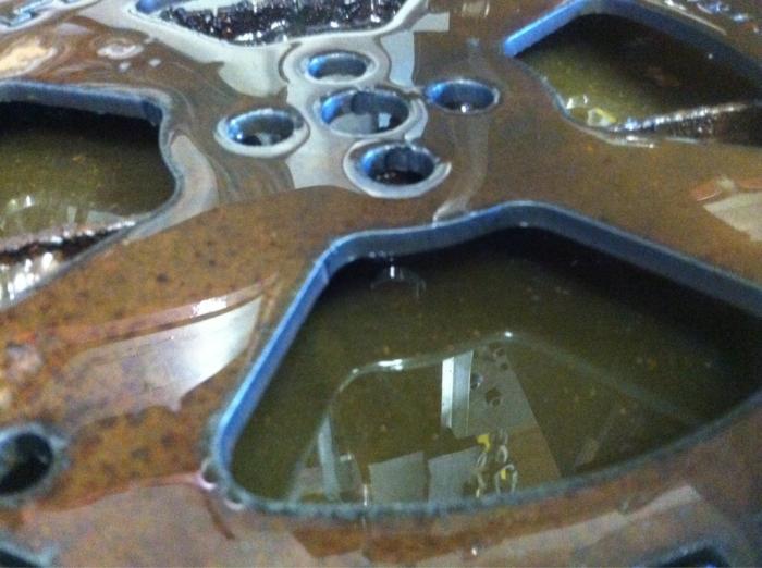

Cut this earlier today

Beautiful! What's the purpose of the missing tooth?

Homemade crankshaft postion sensor stator?
In which case the missing tooth tells the computer "the next signal is TDC #1" or something like that, to maintain synchronization.

Valid point Steve, however I don't remember the moving components being called a stator :)
I'd call it a reluctor wheel if I were going to call it anything, or a tone wheel. MSD and AEM call it a trigger wheel.

GreinTime wrote:Valid point Steve, however I don't remember the moving components being called a stator :)
Ouch!
Yeah, a "stator" is a static part. "Reluctor wheel" would be a better descirption.
Like mom said, "Listen to what I mean, not what I say!"

Looks like a trigger wheel to me...lol

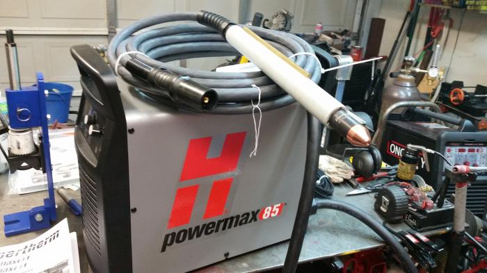

I've been thinking about trying to talk my employer into letting me buy one of those build kits an use our Hypertherm 85 to gain a plasma table....man I see a ton of uses.

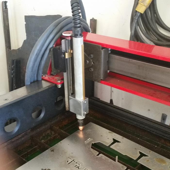

Got a new cutter for the torchmate

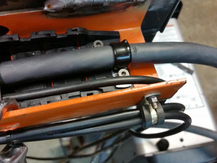

Built my own torch holder also

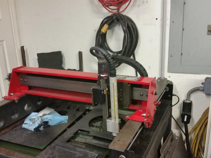

want to build me one too? How do you like the green liquid? Any why do you have slats in every other slot?

gamble wrote:Looks nice.
The plasma green works well, I ran out of slat material so I skipped over some

Green liquid? What are you folks talking about?

bryanwi wrote:Green liquid? What are you folks talking about?
I add plasma green 1050 to the water table to keep corrosion down and it's also a biocide
