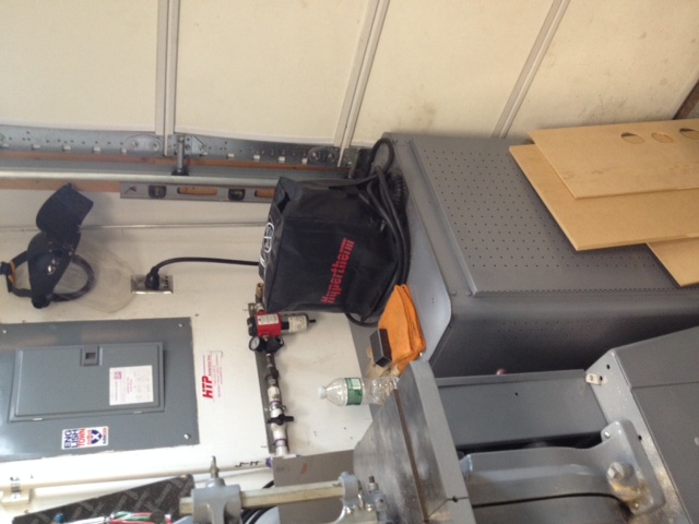

I was talked into a Hypertherm 30XP... Anything you'd buy / have on hand other than what came with the thing? I know it's a small machine, but 99% of the stuff I will be doing will be way under 1/4" and 3 minutes of cutting is a LOT of cutting.
So if you have any tips and tricks you can share for small machine cutting, that'd be great. I see a bit on the forum, but it seems centered around commercial use and larger machines.
I've no personal experience with that unit - but Lanse has several videos on his channel using his new 30XP - I think his most recent showed a consumable kit that included a narrow kerf nozzle - he showed it cutting thin material as a demo of the cleaner cut & less heat / distortion on the part - you may want to get that kit - other than that as per any plasma cutter I'd look at your air supply & concentrate on keeping it as clean & moisture free as practical or funds allow.

- photo 1.JPG (94.92 KiB) Viewed 2610 times
- photo 2.JPG (98.52 KiB) Viewed 2610 times

Well, my original want was a Victor machine for $900... which I think would have served my purposes. Local welding jobber (Airgas) told me that they have lots of issues, and that I really wanted the Hypertherm. It was $400 out of my budget, but I bought it anyways.noddybrian wrote: Why would you need talking into a Hypertherm ?
I'll play with it next week and return with my findings.

Played with the machine tonight. It is everything promised and more.
First cut was in some 1/4" angle. zipped it right off. Then hacked on some old plow disks etc. Really nice piece of kit.
