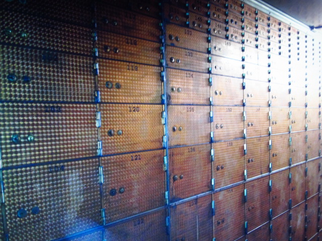

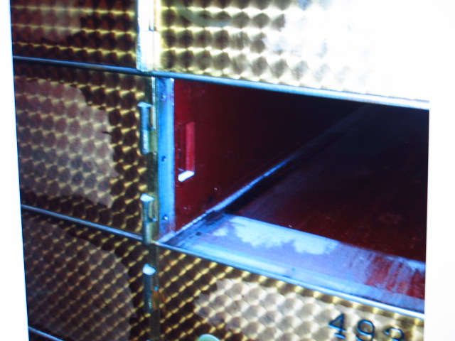

Here's some pictures, they should help explain what I'm trying to do. The first is the wall of deposit boxes. The boxes are built in sections, each holding a certain amount of boxes. Once a section is free, i will cut off the back of them leaving what you see in several seperate 4 x 6 sections. Measurements are just guesses here.
The second and third are the locks. I didn't take these pictures so if you need a different view, let me know.
There are 2 more, I'll put them in the next post
Other Steve
Other Steve
- IMG_8209.JPG (154.22 KiB) Viewed 3276 times
- IMG_8206.JPG (107.65 KiB) Viewed 3276 times
- IMG_8207.JPG (129.72 KiB) Viewed 3276 times

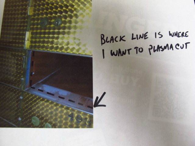

These two show the inside of one of the boxes. This ones locks got drilled out. On the second picture, i drew a dotted line where I want to cut. The doors and whats left of the frame will be used for table tops, the back part is scrap.
I hope this helps!
Other Steve
I hope this helps!
Other Steve
- IMG_8208.JPG (106.1 KiB) Viewed 3275 times
- IMG_8204.JPG (89.56 KiB) Viewed 3275 times
In the second picture of the first set, I only see one strike for the locks, opposite the hinge side. If I see that right, it should be possible to use a small narrow-kerf diamond blade (Think "Dremel" size, but get them from an industrial supply) in an angle die-grinder to slice the hinge pins (with spark-paper on that beautiful machine-turned brass, of course), and pull the door off complete from the hinge side. Examine the jamb, bolt(s) and strike(s) on the "drilled" door to see if this could work.
Since it's now going to be decorative, the hinge pins can be repaired (if needed) by counterboring the "pin" side of the hinge and TIGging in a 304SS pin the right diameter, once you have the frame separated.
IF this idea can work, you can pull all the doors (matchmark the frames), and hack the frames off at will.
If, however, the doors have bolts and strikes on the hing side, or top-and-bottom, this cant work, but that's not what the picture appears to show.
Two cents...
Two cents...

Thanks,it's certainly a workable solution if it can be done that way. I'll forward it to the powers that be and let you know what they say.
You can see now why I was worried about effing up the brass with the heat from a plasma cut!
