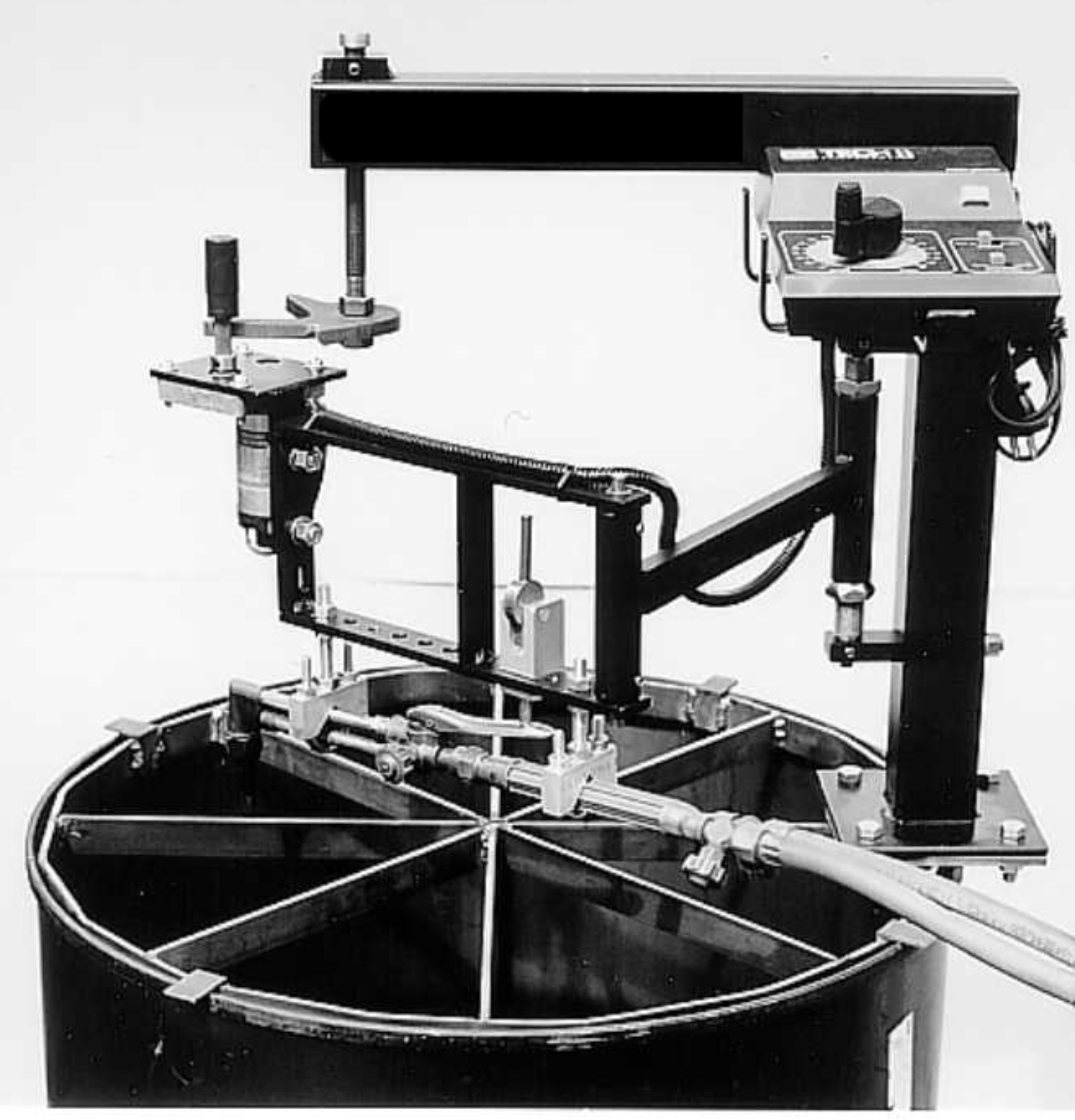

Pantograph shape cutting machines, first patented in 1917, used oxygen-fuel cutting torches for such work. These little workhorses are passe' since "electric eye," and later CNC, technology came about. However they still might have a use for those lacking the space or the need for a more sophisticated system.

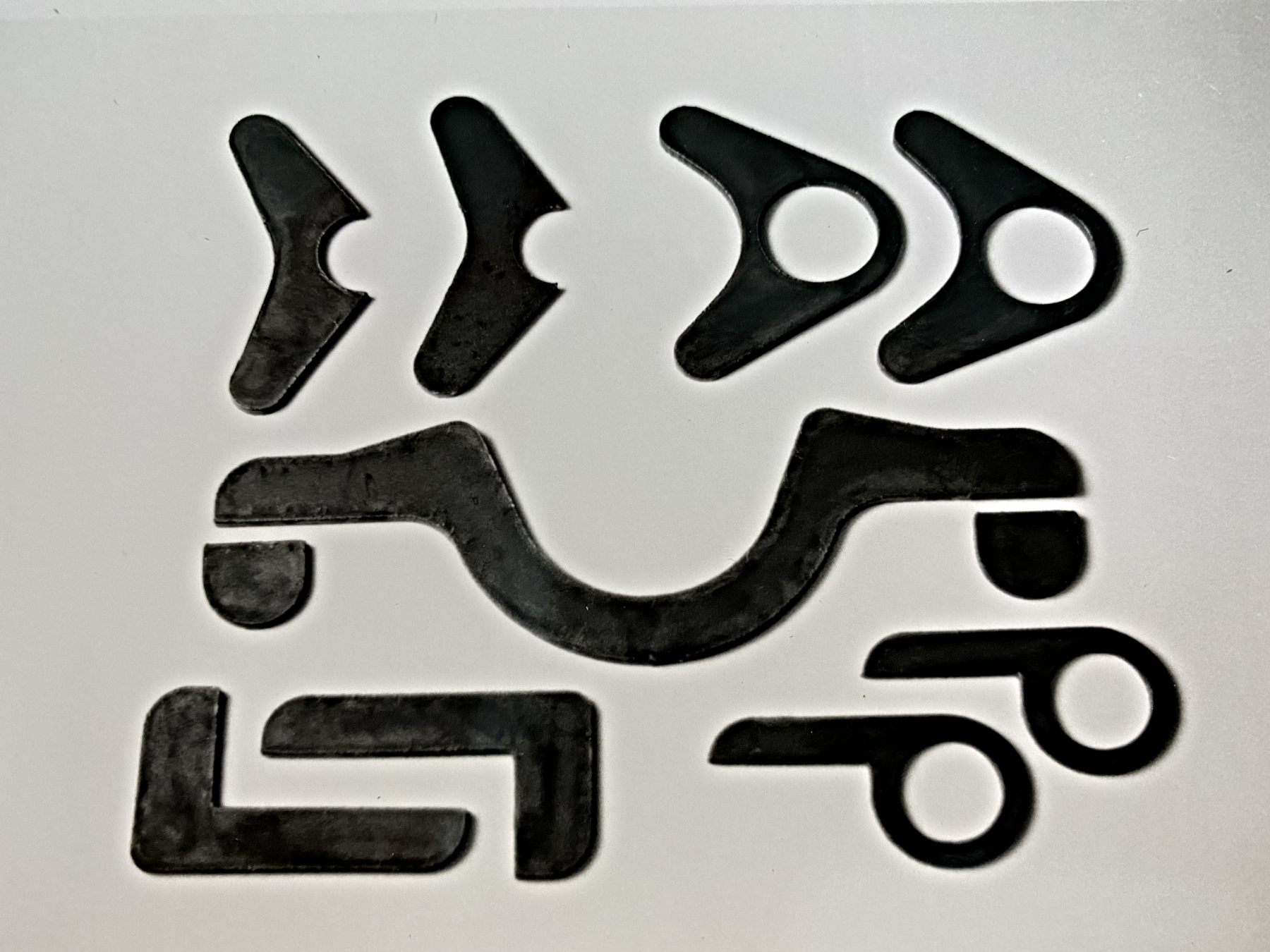

Pantograph machines can cut simple shapes just as smooth as a CNC machine. They use a knurled, magnetic rotor traveling around the perimeter of a 1/8" or thicker steel template. The torch tip, directly below, duplicates the shape in steel. A slight size adjustment in the template must be made to offset the diameter of the tracing rotor. The formula for an external shape is to make the template smaller by 1/2 the diameter of the rotor minus 1/2 of the kerf, or gap created by the torch. The opposite is true for internal cuts. They can cut straight lines using a straight edge for a template.
Since the steel template is just as difficult to make as the part being duplicated, the process is most useful for reproducing multiple copies of the same shape. One-offs can be cut by using a wooden template, and holding the knurled rotor (a rotary burr) against the edge of the template, changing the direction of manual pressure as it goes around corners. Internal shapes can be cut by using a template with the desired internal cutout. The motor shaft is moved to the inside of the template, and the magnetic rotor then placed back on the motor shaft. Starting at the edge of a drilled hole simplifies the operation.

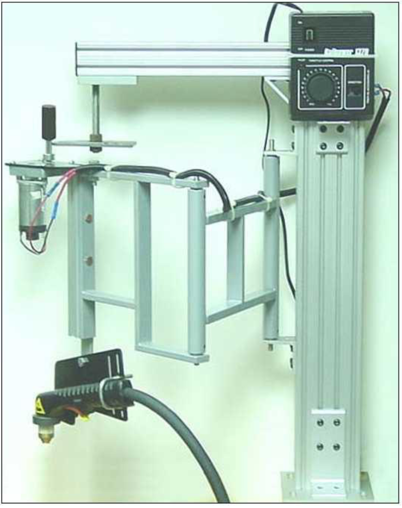

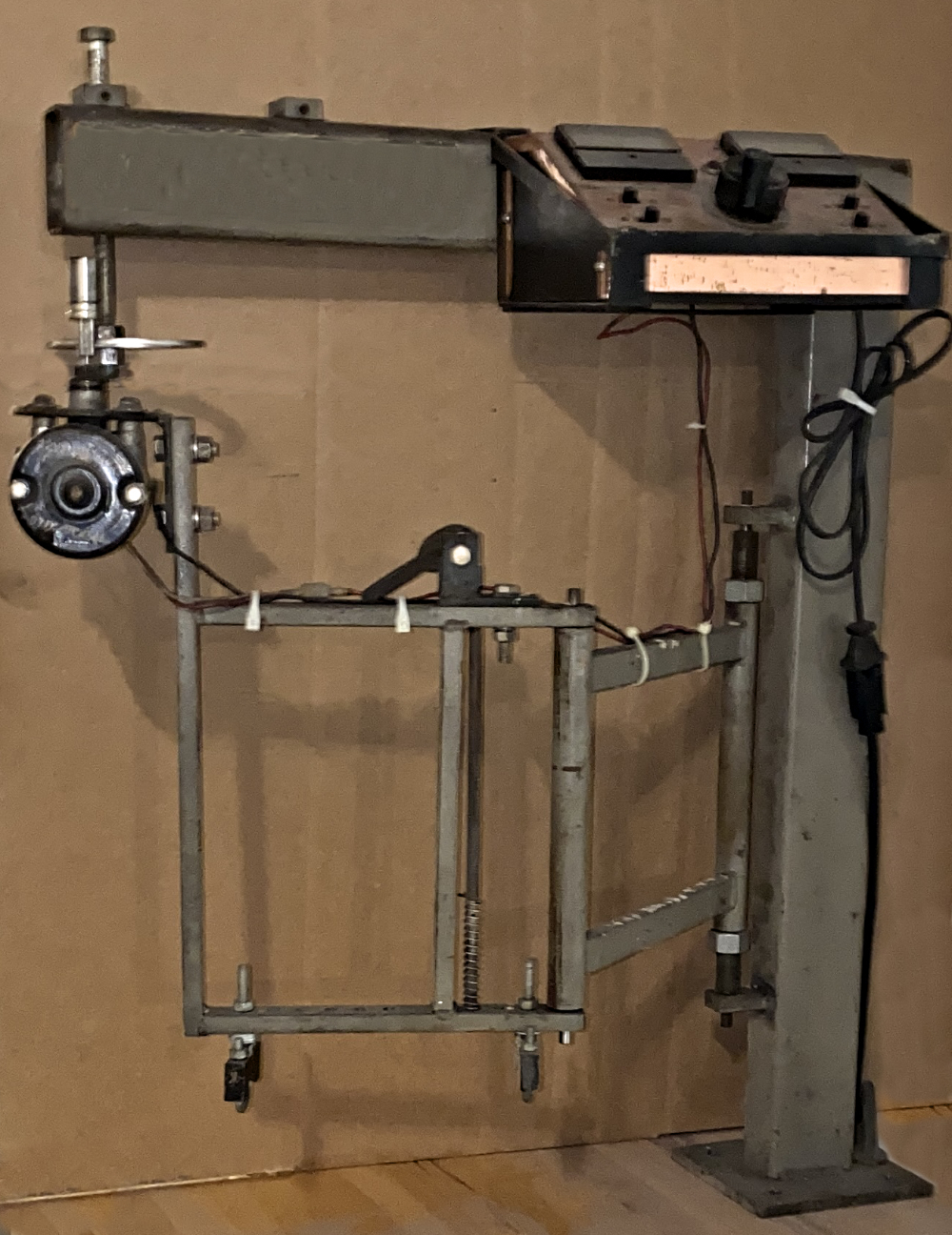

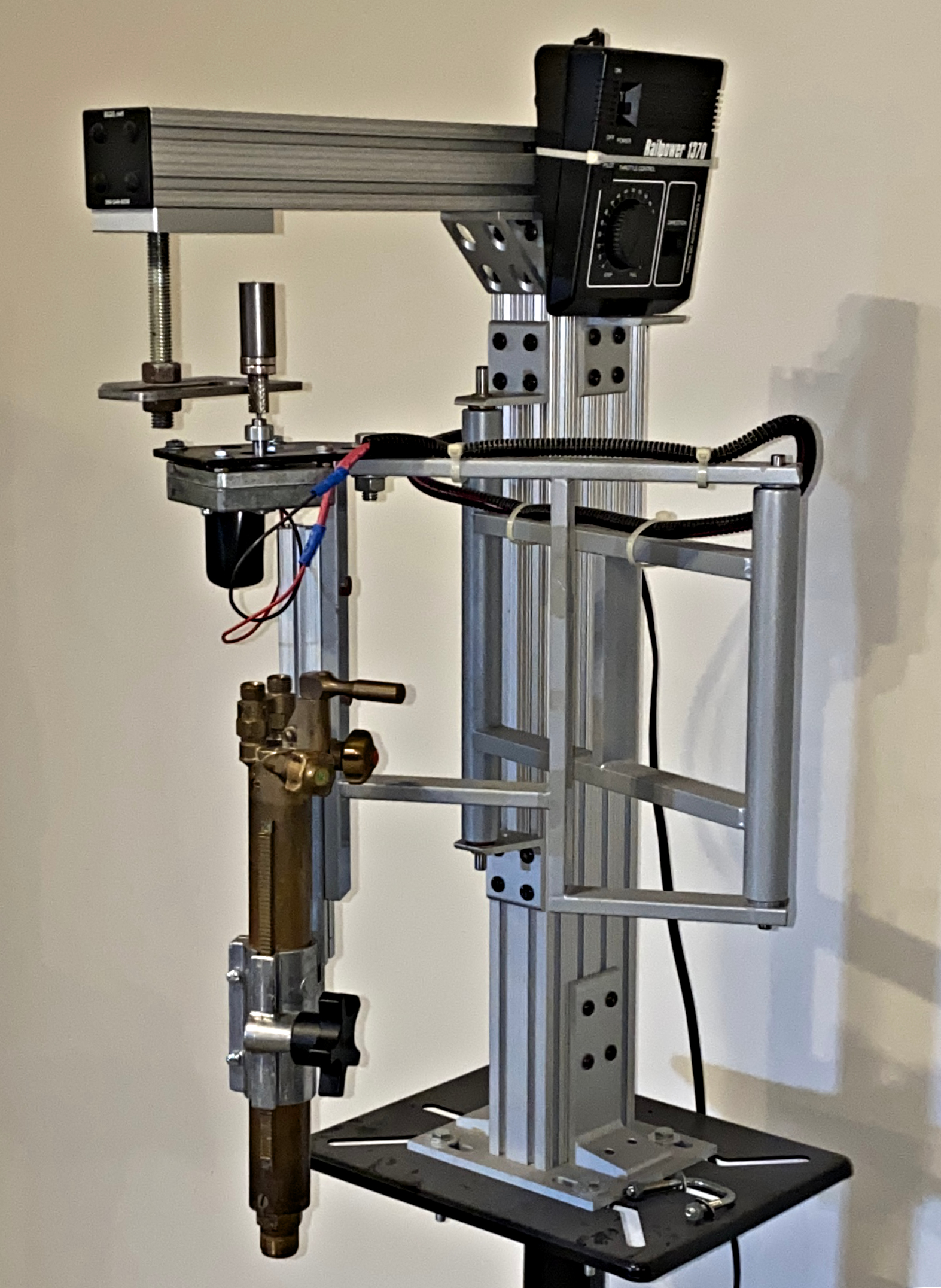

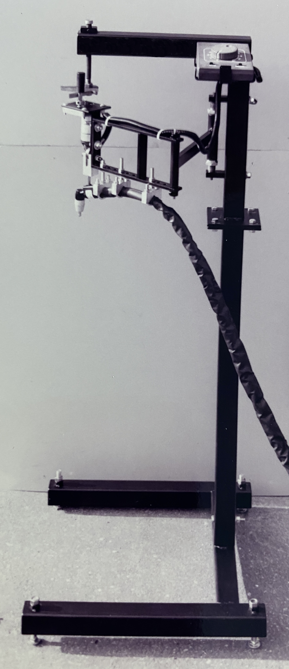

Long before getting into CNC plasma cutting, I built a number of pantograph cutters. Below are some photos starting with the first one I made (which I still have) up to the last one, which used 8020 aluminum extrusions in its construction.
