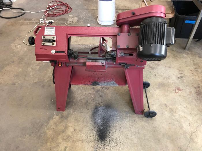

Well, might be the end of an era for my cheapie Harbor Freight 4x6 bandsaw after nearly 7 years of HARD running. The vise nut cracked today. Looking at the geometry of the crack, I don't think an attempt to weld or braze is a great option. Looked into machining a new part myself, but the tooling cost to cut the acme threads would be a non-starter for this. Even buying an acme nut to weld onto a machined part would cost more than a replacement vise nut to my door (about $45 total for the replacement part). $45 doesn't seem so bad but she's starting to show her age in many other areas as well, specifically some slop buildup in the main pivot hinge, so it may just be time for retirement instead of sinking money into bandaids each month.
For what I paid for it new (about $210), she has been an unbelievable workhorse the past 7 years. Definitely one of the best values I've ever gotten from HF. Has even cut through 4" thick 304SS round. Used coolant and it took several hours, but she handled stuff like that without even blinking. Miles of metal passed through her. Gonna miss the old girl.

Have you considered changing that vise bolt to a stud?
You might be able to braze a piece of threaded rod into the partial socket, then braze the broken chunk on the exposed edge of the stud and to the fracture surface? I think all-thread is available in both Gr2 and Gr5, so choose wisely.

Really, that doesn’t look all that hard to fix judging by the picture .SusKatCas wrote:Have you considered changing that vise bolt to a stud?

It cracked right through the thread, which is also the exact portion of the nut that takes most/all of the vise load, and it's also made out of whatever pot metal the kids were calling cast iron that day in Shanghai. If that seems like an easy thing to fix reliably, then your skills are just better than mine.drizler1 wrote:Really, that doesn’t look all that hard to fix judging by the picture .SusKatCas wrote:Have you considered changing that vise bolt to a stud?

It's only a few inches, and is literally just an acme threaded nut with something similar to a T-slot casting to guide in that track. The vise block threads into that T-slot casting. I already "repaired" it, though, by flipping it around and drilling/tapping the vise-mount hole to accept a longer bolt. It's a bandaid but has held up. That saw really needs to be scrapped soon anyway. Among other things, the pivot bearings for the saw body are worn out, and just a breath away from no longer allowing a consistent cut. I like it because it's small, though. Great for cutting up small stock.BugHunter wrote:How big is the part and what does the rest of it look like?

So, no half-nut quick-release vise? Just a full circumference acme threaded part with the additional T slot above and a threaded hole for the vise jaw? Aw that's a slam dunk. You could make that in a few parts and weld it up if you wanted to. If you need a part acme tapped, send it.Spartan wrote:It's only a few inches, and is literally just an acme threaded nut with something similar to a T-slot casting to guide in that track. The vise block threads into that T-slot casting. I already "repaired" it, though, by flipping it around and drilling/tapping the vise-mount hole to accept a longer bolt. It's a bandaid but has held up. That saw really needs to be scrapped soon anyway. Among other things, the pivot bearings for the saw body are worn out, and just a breath away from no longer allowing a consistent cut. I like it because it's small, though. Great for cutting up small stock.

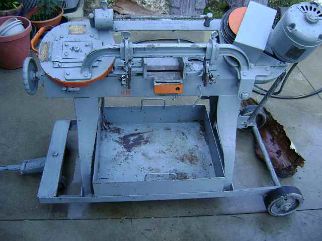

Hi,
I think you got your money out of it, which is good and no regrets.
I found a 1940's Wellsaw 3PH and picked it up cheap.
A gear in the gearbox needed replacing and got it from Wellsaw, that still has ALL the parts.
Completely rebuilt the saw but did not paint it yet.
Cuts like a laser and I run it off the same RPC, that runs my Bridgeport.
