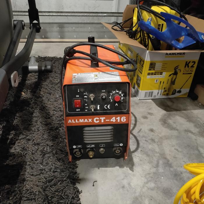

I was given an allmax CUT416 for free (that might be the issue right there). Pretty stoked to get it set up and try it out, so I hooked it up to the neighbour's old compressor and of course had to chase leaks out of that (happily nothing more than a runaround with a spanner nipping up fittings). Anyway, after having to do the same thing with the plasma the whole show was now air tight and ready to go.
I set the plasma to about 0.5MPA and 35 amps (max is 40) off we went with some 4mm plate that I had stripped the gal off beforehand. It cut pretty easily but with only an autodarkening welding helmet that jumped straight to the tig shade setting and no experience, I couldn't really see what I was doing so I missed both ends so the plate ended up still in one piece just with a fairly neat for a noob gouge down the middle. The torch was not dragged or touching the plate the whole time. I thought nothing shade 5 glasses and lots lots more practice couldn't fix.
The cutting tip looked a little worse for wear after just one run with some dark grey oxidising but I thought it would be good enough to finish the job and do another run. The other bits like the little white plastic ring diffuser and electrode looked a bit worn as well. If this is how it normally operates, no wonder you can buy consumables in bulk.
Second time around pressed the button and the usual hiss of air but no arc whatsoever and none ever since. After another few button presses (which started the air every time), I grabbed a complete new set of consumables except for the white cup bit that looked fine and same drama - no arc. The closest I was able to get to an arc was a tiny flash of light about the same as you'd get from a little bulb torch with flat batteries.
The machine is budget spec chinese stuff and the torch is the little PT31/LG40 style 2 prong plug. Interestingly, pulling the new consumables out, there are little 'arc spots' on every piece like a noob learning stick welding and getting little arc strikes - the double ended electrode and the cutting tip have these, so it's like power got thru but the whole thing short circuited or something. Pretty sure there's only one way to put it all together, electrode goes in first, then plastic gas ring, then cutting tip on top and then white plastic hood that screws down to hold it all in tight.
So I'm trying to work out why there's no arc. If I can get air thru fine then I'm assuming that the torch button switch is ok. As for why there's no arc or the tiniest flash of one, I can't work that out but are there any tests that can be done to work out where the problem would be ? I guess it can only be the torch or the machine itself. It has a tiny 0.5amp fuse and I checked that and it looks fine.
Also gives me an idea of compressor size I need as the compressor says it's a 7.3cfm with a 21 litre tank. It pumps up to 115psi and then auto cuts out and then cuts back in but not sure at what point it does that. Anyway I found that 21 litres does not go very far at all.

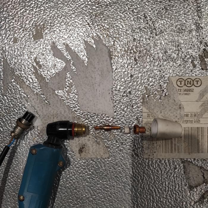

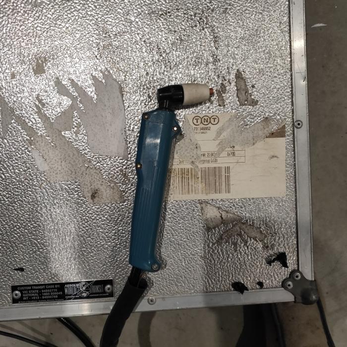

Here are some photos showing the 2 pin plug.
Next is the torch with consumables in order of how I put it together, from left to right. This is the set used that first time it worked and just from that short run things got pretty dirty.
- Not so good photo sorry
- plug.jpg (130.87 KiB) Viewed 5209 times
- torchsplit.jpg (138.98 KiB) Viewed 5209 times
- torch.jpg (119.22 KiB) Viewed 5209 times
- Beast.jpg (86.55 KiB) Viewed 5209 times
Yes that is a generic PT31 torch - the consumables look fine - I meant there are 2common lengths of them & an oddity extra long 1 - you have what is generally referred to as the extended sort & appear to be a matching pair- with regard to touching I meant if you had a long electrode & short contact tip or missed the swirl ring out ! it can happen - unsure of your model but it appears to be a multi process which I never seen - are the switches all in the right place ? also you can plug the earth clamp into the positive or negative - any chance you got this wrong way round ?

Well after mucking round with it more including rechecking the torch plug wiring at the machine end (when I got the machine the wires had frayed and were touching so I resoldered when i got it), jamming the plug back into the machine as far as it would go and holding the button down the whole time when operating... we are in business. 60psi and 30 amps it had no trouble blasting thru 4mm plate that I had de-gal'd with acid. Pretty stoked it is now up and running.
I had ordered a new pack of consumables from china a month ago that actually finally arrived the day I was mucking round with the machine again and tried them and they fitted even better than the ones I'd bought from a local supplier. The band in the middle of the electrode sat properly in the cup of the torch head whereas the local stuff was a tiny bit narrower in diameter and so had a bit of play. Either set seems to work as well as the other though so I'm pretty happy I didn't waste money.
The cutting arc or whatever you call it is very fine and it picks up the slightest wobbles in your hand better than any tig setup could so I need a lot more practice and working out how to use some angle as a straight edge brace for it.
Anyway, thanks a lot again for your interest.
