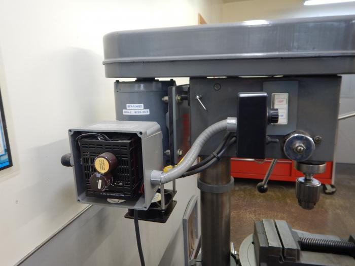

After having it for 10 years the 4 best uses for spending money and time to fit a 3 phase motor on your existing drill press:
-Improved cutting speeds for steel to cut a hole and preserve the drill.
-Actually being able to drill stainless 304 and 316- almost like steel.
-Use of a countersink to cut a clean hole without chatter.
-Better drilling for hole saws
I keep a drill doctor anyway for maintenance
VFD - Anywhere really - I used KB electronics in Florida $125 back in the day
Motor - Ebay $50 - century 1 hp motor from a Texas Grain mill.
Computer Fan - Internet - This one's 220v
The drill press was a 1973 floor mounted press when Taiwan started importing tools into the U.S.
Basics - Get the frame# off the existing 110 motor and 3 phase should match it for bolt pattern and shaft size. The fan offers motor cooling you loose with low motor speed drilling. I called KB and told them what I wanted to do, they gave me the unit best suited for it and what I needed in the replacement motor.
Options- Find something without a motor. Match the motor holes to get a frame size and replace the pulley with a step pulley (ZORO or Grainger) or get a 3 phase DP and power it with a VFD.
Far easier than getting a tread mill motor and building mounts for it. A VFD would be great for a lathe or band saw but I'm not looking for an excuse to quit dirt riding yet.

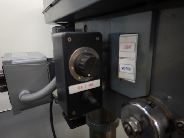

This is for Oscar if he hasn't pulled the trigger on buying a new unit.
- Basic Controls for speed on the fly
- DSCN1937.JPG (24.93 KiB) Viewed 5693 times
- Where it stays for 90% of the work with the VFD

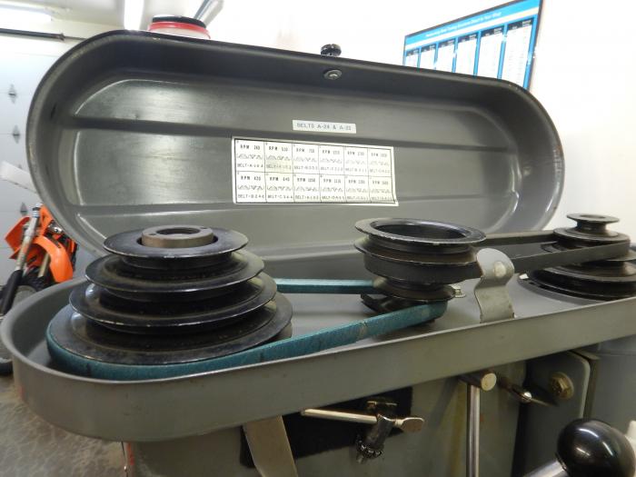

- DSCN1934.JPG (44.55 KiB) Viewed 5693 times
- Mounted up and good for the last 10 yrs
- DSCN1936.JPG (36.53 KiB) Viewed 5693 times

Changing pulleys for speed control is not half as good as twisting the POT on the fly. Just like welding with low too of an amperage- we start slow, and put a slow rate of down pressure on drill. It generates heat and ruins the bit.
Better if you can run a higher feed and pressure rate for cutting material to cut friction and heat.
Stainless best demonstrates this. On the small lathe I run as high a feed rate and speed I can to prevent heating and hard spots. Same with drilling stainless - especially stainless. Sure, you can pop the lid and move belts, but the VFD gives you way more speed options within the pulley configuration at your finger tips.
Adjustable pulleys only offer a direct ratio of torque to RPM. A VFD allows you to maintain the higher torque most frequently associated with a slower speed, but operate at a higher RPM. Imagine drilling a 1/2" thick plate of stainless 316. You need speed to prevent galling, but you need torque for the thickness and pressure.Oscar wrote:Yes, I agree with the advantages. How would it be different from a drill press that already has infinitely adjustable speed (not stepped pulleys)?
