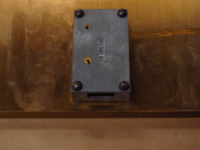

Here's another update to our ongoing table project. We laid out the doors in the pattern that they will be on the table and mortised out a sheet of 3/4 MDO which is part of the base to hold the doors in place. We had to mortise out for the lockset boxes that are on the back of the doors. While the boxes are removable, the door locks are attached to them and they want to keep the locks. The second picture shows the back of the door with the lockset box. We also had to cut off the bolt part of the lock with a horizontal bandsaw because it would have just gotten in the way of the mortise.
Tomorrow I'll cut the angle iron for the table frame and start welding up the base out of 2 x 2 square tube. I might actually have one complete before Labor Day! :lol:
