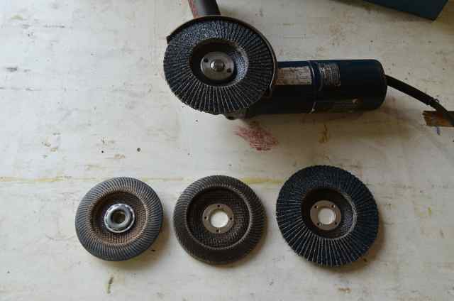

I ended up getting a ten-pack of 5" 40g tigerpaw discs for $23. They worked great on a wrought iron job I did last week adding 50 intermediate pickets to a railing to make it kid safe. One disc removed all the paint for welding and still has a lot of life left. I used my variable speed 5" Bosch at a medium speed. The 40 grit worked great as my previous discs were 60g, old, and glazed. Customer was pleased and I made good money.
Pic shows old discs I had been using center and left with new discs right and on grinder. That's my old high speed grinder. A couple of the new discs were out-of-round and worthless.
