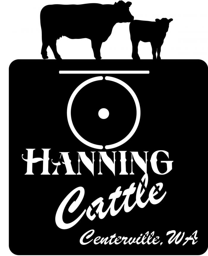

Cut out and powder coated a sign for a rancher today. Circle part is their registered brand.

Nice sign ! :
What is the thickness of the metal, and what type of metal did you use?
What is the brand name of your plasma cutter X-Y table?
What is the brand name and model number of your plasma cutter?
How do you like the user interface of the plasma cutter X-Y table software program?
Does the user interface allow you to tweak the variables in the equations that run the X-Y table?
What computer (Mac of PC) are you using to control the X-Y table?
What interface bus connects your computer to the plasma X-Y table controller?
What did the plasma cutter X-Y table cost? (minus the plasma cutter)
This info would help me as I research my own purchase of a plasma cutter X-Y table.

What is the thickness of the metal, and what type of metal did you use? 14 ga. CRS
What is the brand name of your plasma cutter X-Y table?Self made
What is the brand name and model number of your plasma cutter?Hypertherm
How do you like the user interface of the plasma cutter X-Y table software program?love it, CorelDraw, Sheetcam, Mach3
Does the user interface allow you to tweak the variables in the equations that run the X-Y table?yes
What computer (Mac of PC) are you using to control the X-Y table?old dell, XP Pro
What interface bus connects your computer to the plasma X-Y table controller?Mach3
What did the plasma cutter X-Y table cost? (minus the plasma cutter)I was to scared to keep track

plain ol Bill,
SELF MADE!!!
, now you have really peaked my interest, can you elaborate ? How about a few pictures ?

Here is a link to how I went about making it.
http://www.cnczone.com/forums/plasma-ed ... ost1414410

Great job.
I got interested in the first 'e' in the word "Centerville"
What held the center of the top part of the letter e together?
Trev
Trev
Decieveing isn't it?TRACKRANGER wrote:Great job.
Trev
Look a little closer.
I think cutting letters with this font will be extremally hard

Sometimes I scratch my head over it too trying to figure out how to keep parts from dropping out.

I looked closer. I must need a better monitor. What model do you have?AKweldshop wrote:Decieveing isn't it?TRACKRANGER wrote:Great job.
Trev
Nice setup ya got there Bill
