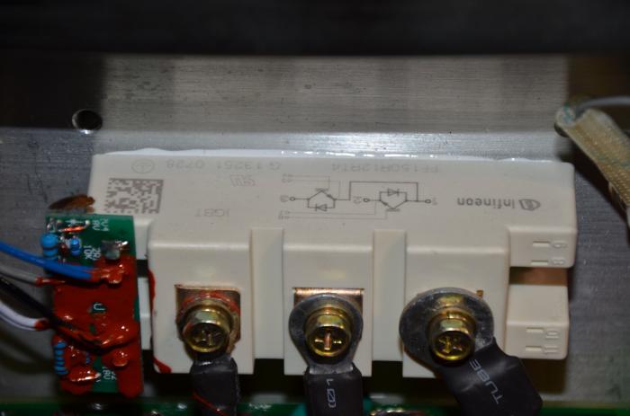

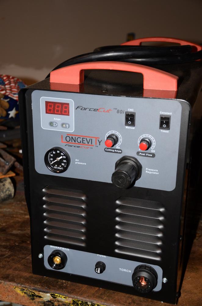

So with all that said, I am off to the garage! Here are a couple of pics for everyone to look at! Well, I went out to the garage, took the cover off to do a "pre-op" and double check all the nuts, bolts, screws etc.. I was a bit surprised as I only found 4 case screws that were just a tad loose, however I did notice that the top rack is bowed and the bottom circuit board is rubbing the bottom of the case. I wonder if it is supposed to be like this or if I should attempt to straighten it with a support brace on both sides.
One more thing, that LARGE RED cooling fan... All metal! I like the quality so far... tomorrow we see it in action!

- Infineon IGBT's
- DSC_2408^.jpg (31.44 KiB) Viewed 2094 times

- front of machine
- DSC_2374^.jpg (68.43 KiB) Viewed 2094 times

One thing that I am impressed with is the use of the Infineon IGBT modules, they are made in Germany and I have confidence in their products.

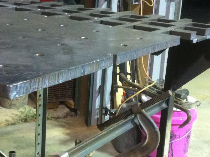

So, I haven't been online lately due to computer issues but I have had time to play with my new machine and I must say I am very impressed. I don't have any plasma experience so I have nothing to compare it to however I can say that after my initial test cut and ruining a tip I learned that I must keep the air pressure UP.
here is a picture of my 2nd cut (the entire table top) and it walked through this like it was butter... This is probably the thickest I will ever cut but you never know right.
As far as I can tell from right now, this machine seems to be well worth the money. I am going to be making a few things in the next few months and I will continue to post success and failures from my projects so that everyone sees what this machine can and cannot do well/good.
Here is the pic of the metal I cut on my 2nd attempt ever, I am pleasantly surprised and pleased at how well it turned out. Also a picture of the tip afterwards... I am pleased that I did not hurt the tip.
Oh, please don't hammer me for cutting into my table.. lol. it is a newbie mistake and won't (hopefully) happen again.

- Thickness of metal
- IMG_1171.JPG (70.83 KiB) Viewed 1932 times
- cut of side with gaps.
- IMG_1190.JPG (61.18 KiB) Viewed 1932 times
- cut of solid side
- IMG_1185.JPG (57.18 KiB) Viewed 1932 times
