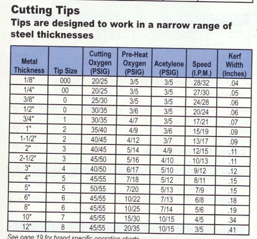

Check this out. Hope it helps.
- scan0001.jpg (104.94 KiB) Viewed 19887 times

set the oxy @ 35-40 psi and the acetaline at 7-10 psi and you should be good for most applications.
A rosebud tip is a heating tip that you use for making a low temp solder joint - copper water pipe, air conditioning pipe. its not a cutting tip. Rosebud tips for oxy/acet torches are operated with acetalene only and get their oxygen from the atmosphere. Or, you can get a rosebud specific soldering handpiece for $25 that operates with MAPP or propane ... and you get a soft, low temp flame which is perfect for soldering a copper pipe.
Cutting requires 40psi oxygen to firstly superheat the metal and secondly to blow it physically out of the way. Kinda like a plasma cutter that uses high pressure compressed air. If you add oxygen to a rosebud tip, you will melt the tip off.

Jim, I think tim is only wrong in name. I think Tim is talking about the slip-on tips made for body soldering and light heating applications. I've heard them called rosebuds (they're not.) before and they are an acetylene-air device and you will pop the tip off the end if you add in oxy. I can't seem to find a picture 'cause I don't actually know their proper name, but theres a brass ferrule with a rubber gasket that slips over a standard welding tip and in the ferrule around the tip there are air inlet holes so the flame can draw air and create turbulence. I think the body on the one my grandpa has is rubber, then it goes to a fairly wide opening tip.
basically, it's just converting your oxy/acetylene rig into a plumbers-style air-fuel torch without changing tips. they work good for what it's worth, but its a hell of a lot cheaper to just use the plumbers torch.

where i come from (n.y.c.) a rosebud is an oxy~acetylene tip or attachment that's used to pre-heat weld joints or heating material prior to bending or forging. the air only torch used in sweating plumbing and/or refrigeration lines is called a turbo torch. for general burning (up to 5" thick)and (rosebud) heating i set the oxygen regulator to 40psi and the acetelene to 10psi. for brazing and silver soldering i reduce these settings by half, 20 and 5psi. there is a large propane heating torch used in roofing and general heating jobs that's also called a rosebud. yeah, it's confusing isn't it?
i set mine at 40# oxy and 5-7# for general cutting. i found that dropping the oxy to 20# for rosebud operation works well. the setting is usually indicative of the btu rating of the tip. the torch manu. should be helpful like the chart i just saw
