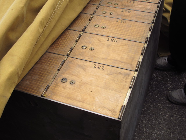

Even with the picture quality I think it's reasonably clear there are 3 lock bars on both the hinge side & the lock side of the door but none top & bottom so cutting the external hinge will not release the door - the hinge is really only there to support the door while open & plays no part in securing it when shut - but I still believe spreading the frame is possible - I'd check the depth of bar engagement on the one that has had the locks removed - if it's not too deep then using wedges is a " normal " solution - or as the internal structure of the units is not likely to be very thick plasma the floor out between the open one and the next above or below so a " Porta Power " ram can be inserted across the opening on the inside - I think you'd be surprised how little movement is needed to allow the door to open.
Good luck with the project - I doubt you'll find much of value - but please post pictures of the more "unusual" items you find !

This is why I said "take a look". Those could indeed be strikes for three bolts on the hinge side, but there is clearly only one strike on the key side. Why three at the hinge? They appear to me to be points securing the hinge structure to the frame. 1920's technology. It would take a substantial key to relilably turn that much mechanism. And, they're locked inside a huge safe. I'm not sure hinge-side bolts and strikes would be considered necessary in 1920. That's why I'm trying to get my brother involved. He could tell me a great deal, but he hasn't replied to my email, yet.
An examination of the removed door, and the box it was removed from, will tell the tale.
Opened that picture in MS Paint, and zoomed in on the hinge side...
Not "strikes". No depth. Appears to be flathead countersunk screws supporting the "pin" side of the hinge bracket.
I believe thin-cutting the pins will work.
Another thought, Steve,
If your examination proves me right, there may be "play" in the doors, so it may be possible to lift them slightly in the frame, so that "thin-kerf" diamond blade cuts ONLY the pin. 1/16" would do it.
I'm not sure I'd "pry" them, at least not without padding, but IF they'll move, a glazier's suction cup and a helper might do it.

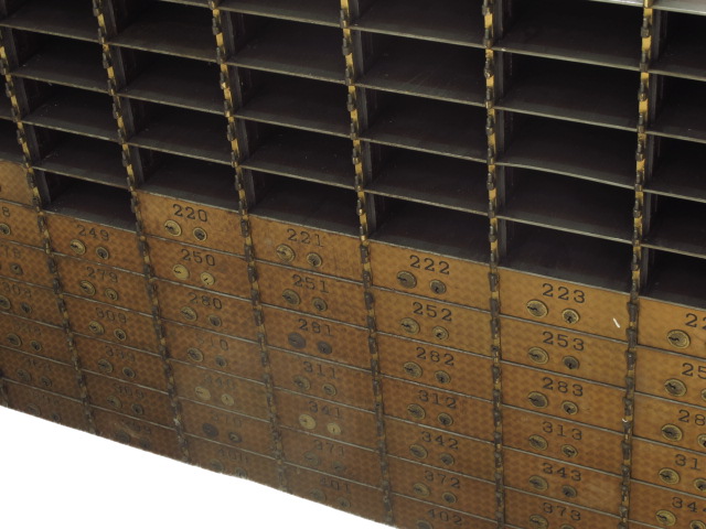

I went over to see the pile. The boxes got taken out of the wall by the demo guys and got put on a flatbed by machinery riggers. On first glance, it looks like Steve S. was right about the hinge pins. I'll know more when I get them in the shop.

Here's one more of the entire pile... I have to get 2 forklifts now. One to put them on a truck from where they are stored and another to get them off the truck where they are going.

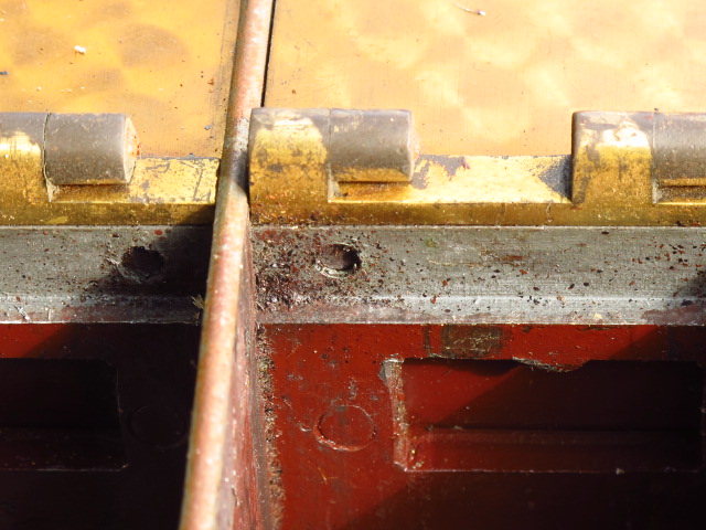

Here's an update on the job. We eventually wound up drilling out the hinge screws on all of the doors and they just popped right out. It was a lot of drilling!
We got to the back side of the hinge screws by removing a metal strip as the 1st picture shows. From there it was pretty easy to drill out the hinge screws. You can see the screw bottoms in #2. Picture#3 is just a small section of doors that we drilled out. There were about a 1000 of them altogether, all different sizes.
From here, the doors go to the shop, get arranged into tabletops and I'll start welding the frames for those next week.
