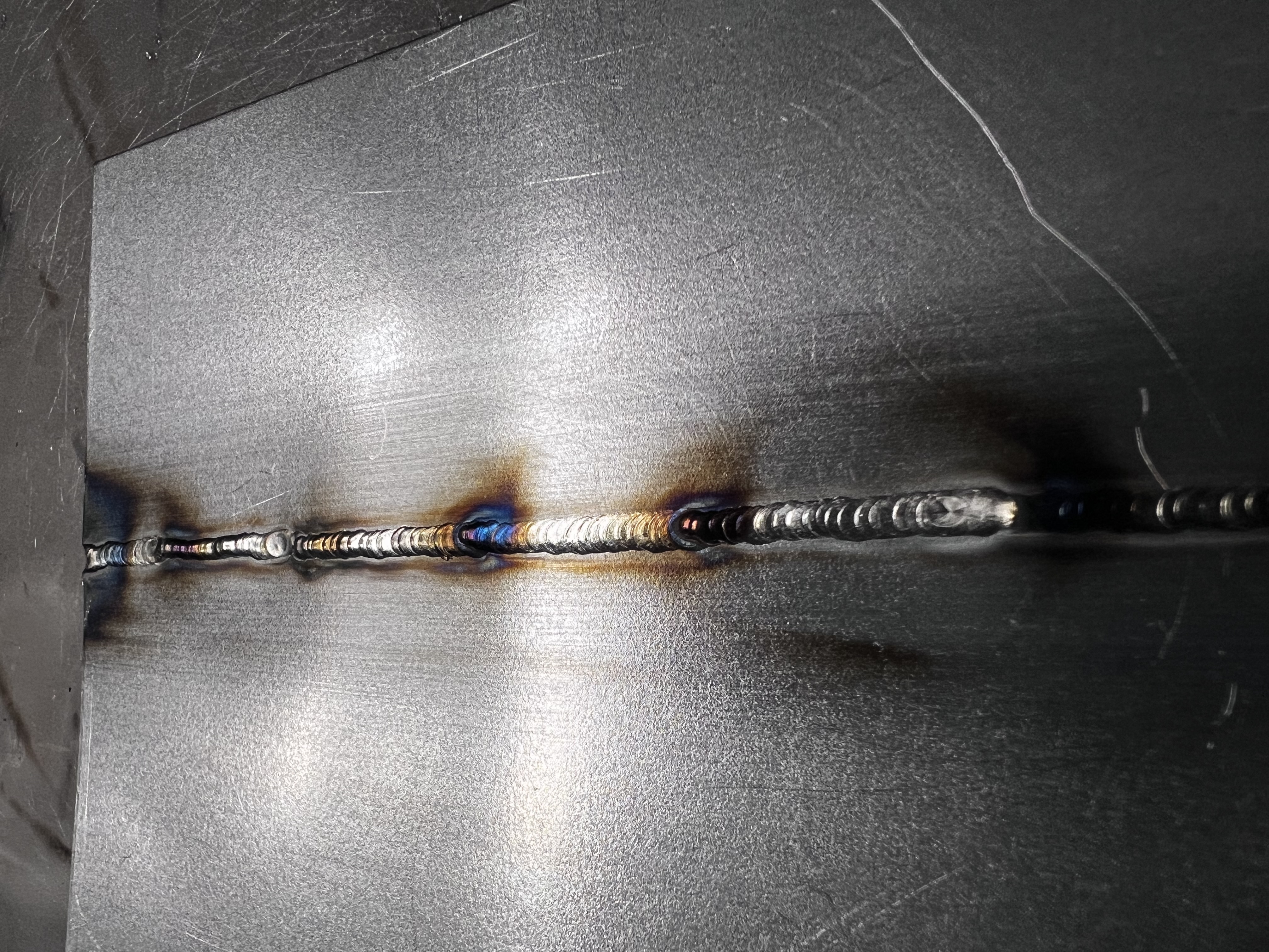

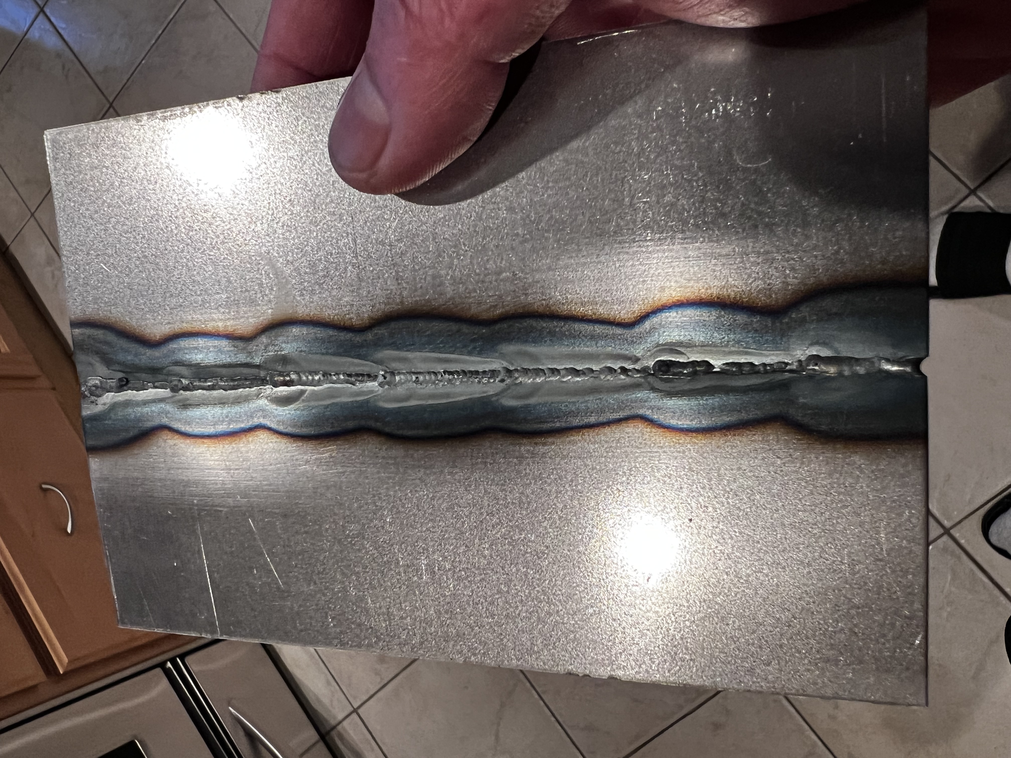

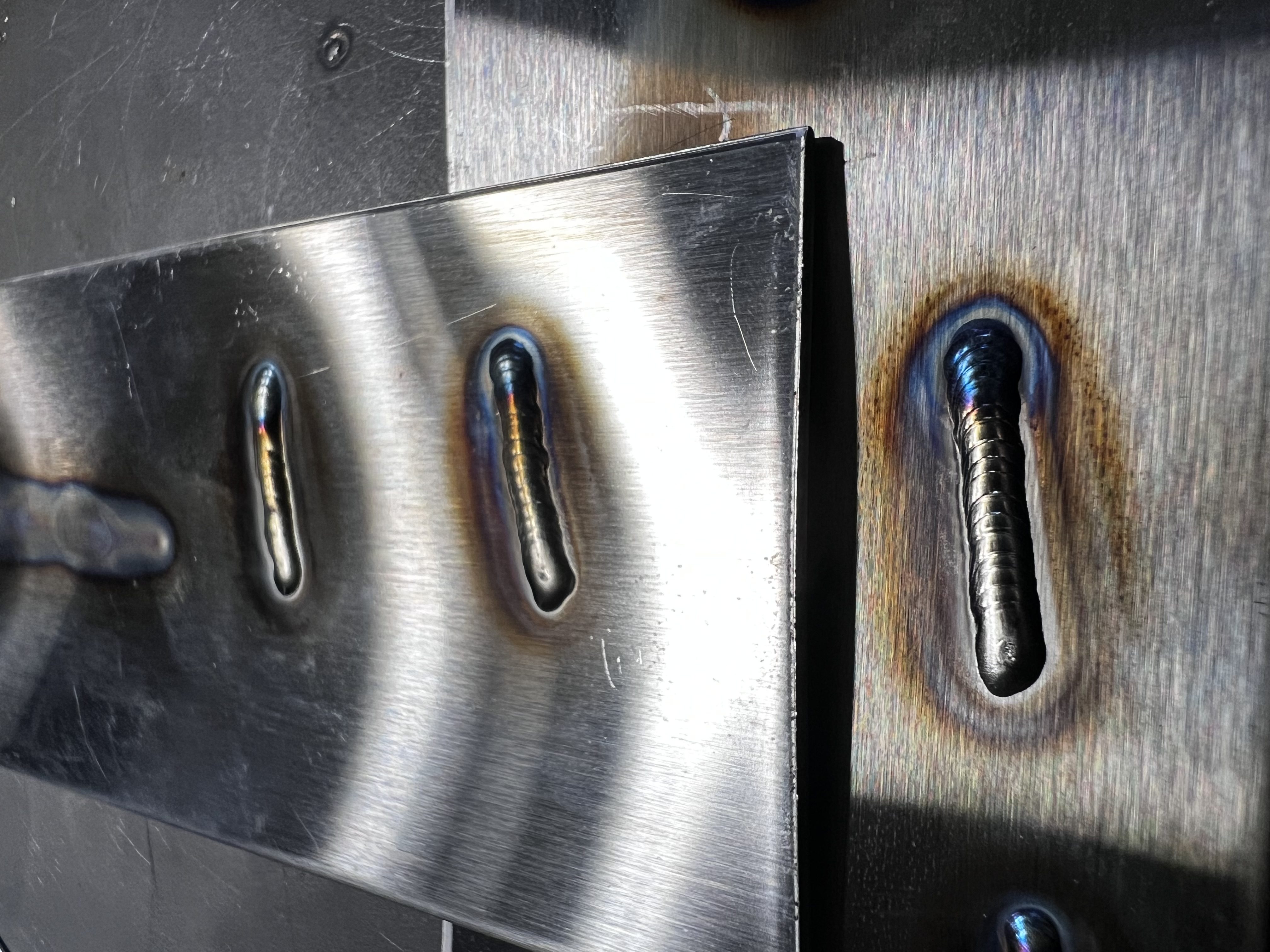

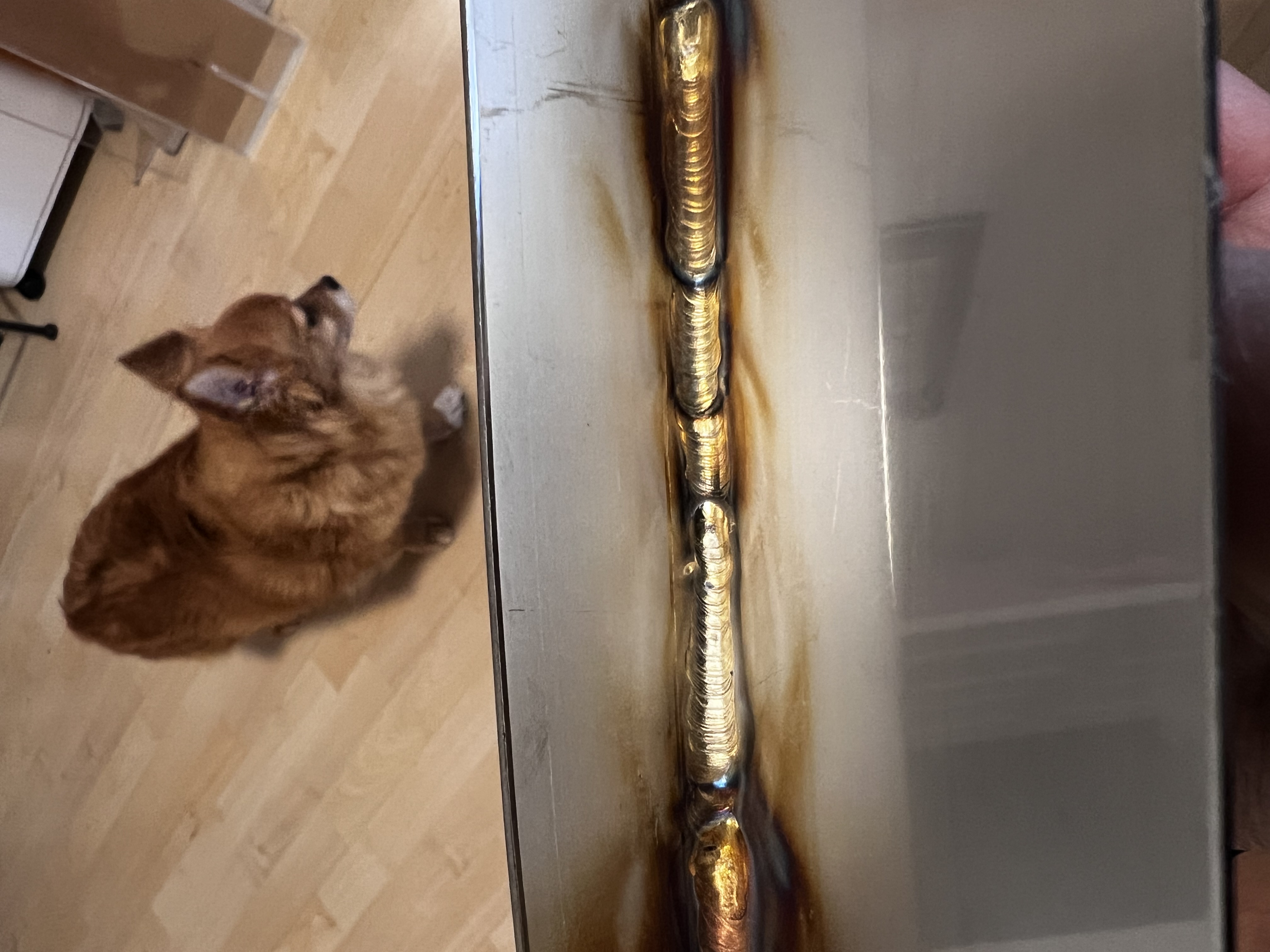

I had a second attempt at a 16 ga stainless T joint. The first one is just too atrocious to post.
Couldn’t find any 18 ga stainless so I bought some 18 ga cold rolled coupons to practice. Below is my 3rd attempts at 18 ga. Already got some 18 ga 304 SS tubing and dual regulator for purging to start practice with going around a tube.
I broke the weld into sections on the pieces to practice my tie-in, that’s why it looks all disjointed. I key-holed a few spots so i will need to practice my pedal work to finesse my taper.

Those look just fine. Just continue with the practice on your travel speed so the bead remains as uniformed as possible. Tie-ins look pretty OK. Perhaps back up into the last bead a bit farther before moving on so there is no gap in the bead. You’re doing really well for someone who claims “beginner” status!

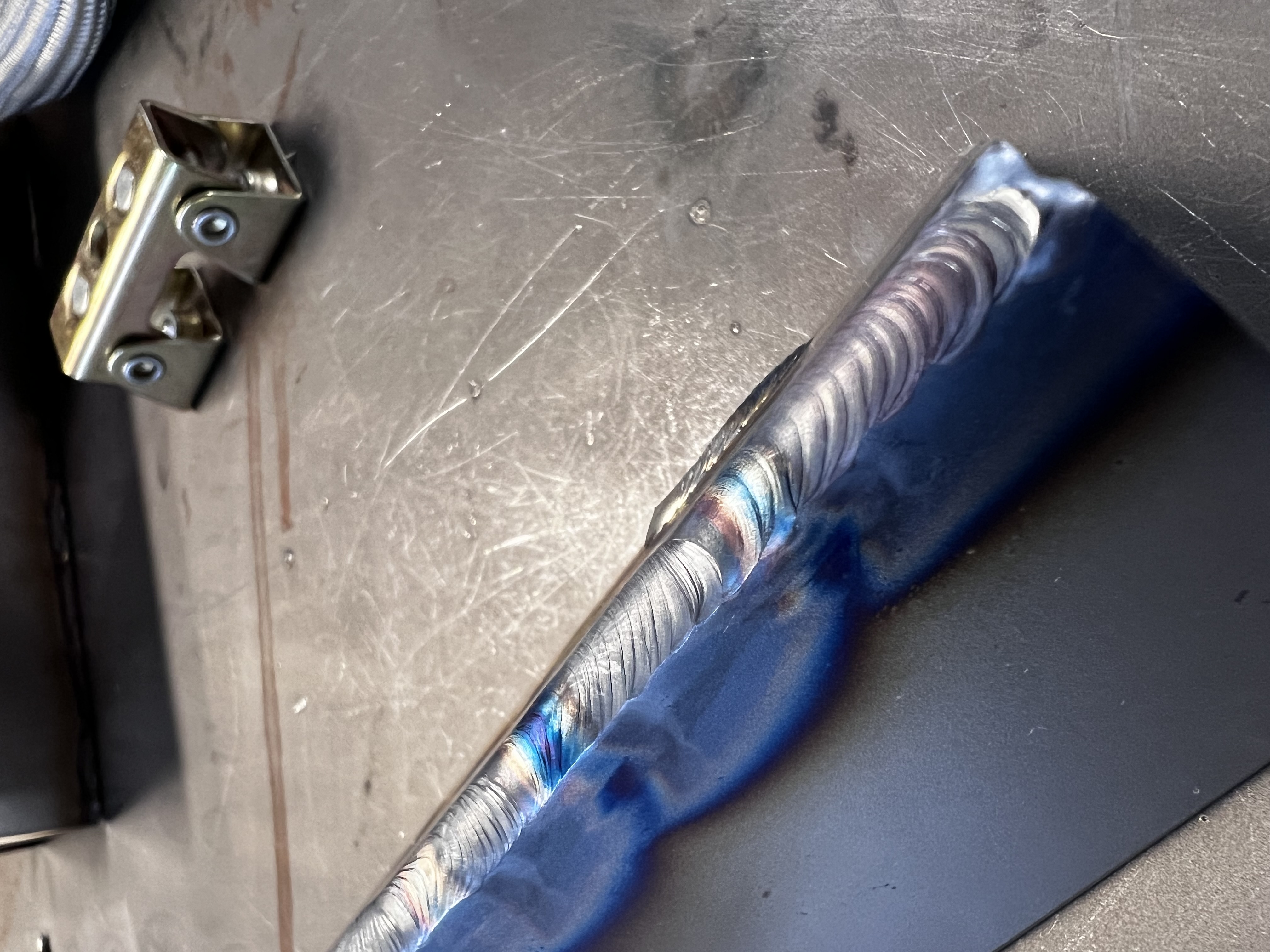

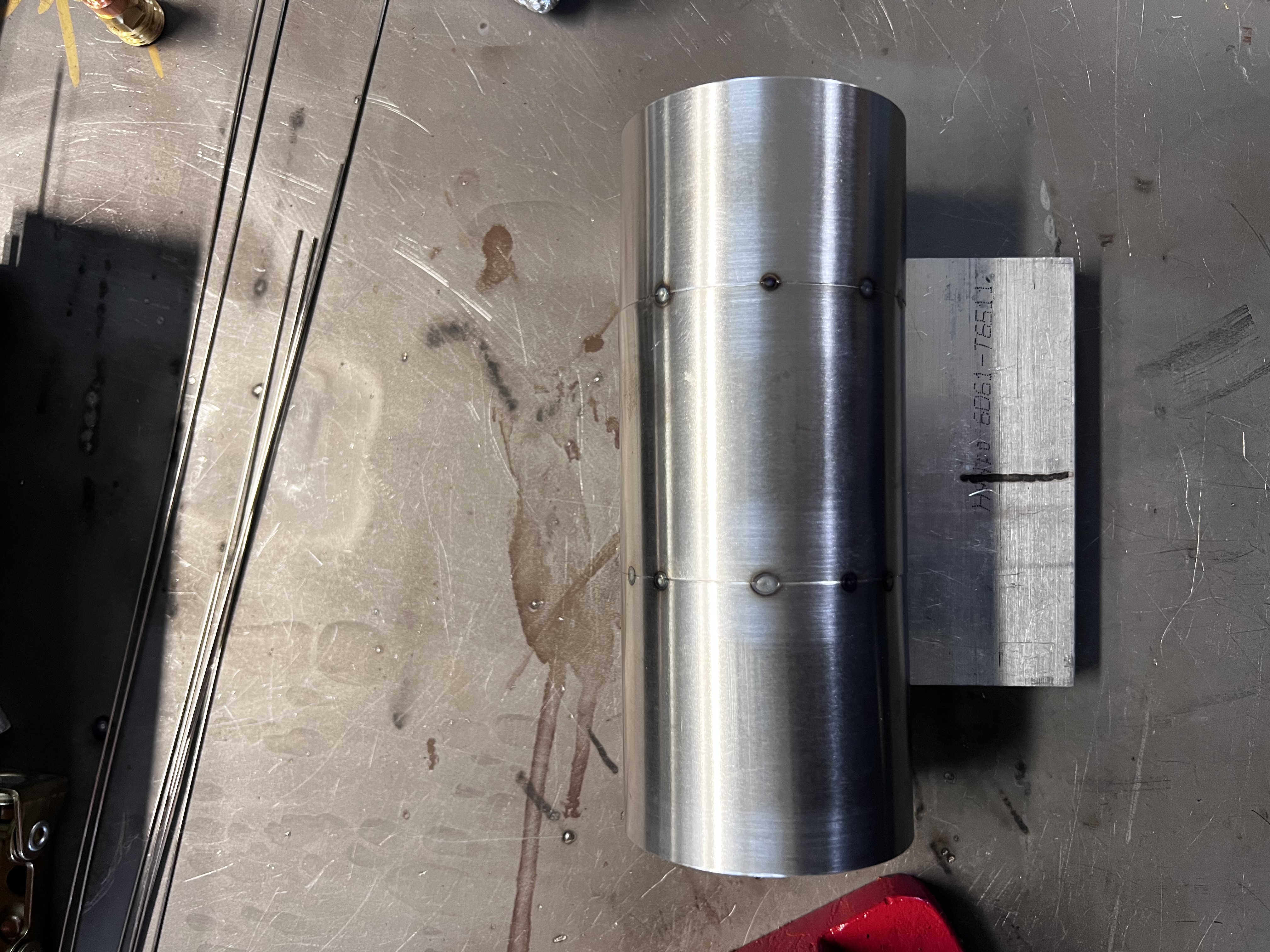

I took a shot at 2.5” 18 ga stainless tubing. I was just running a bunch of beads to get used to the torch angle, dabbing, heat control and travel while going around a tube. A humbling process but still fun.
- 2.5” 18 ga stainless
- IMG_9420.jpeg (2.18 MiB) Viewed 36991 times

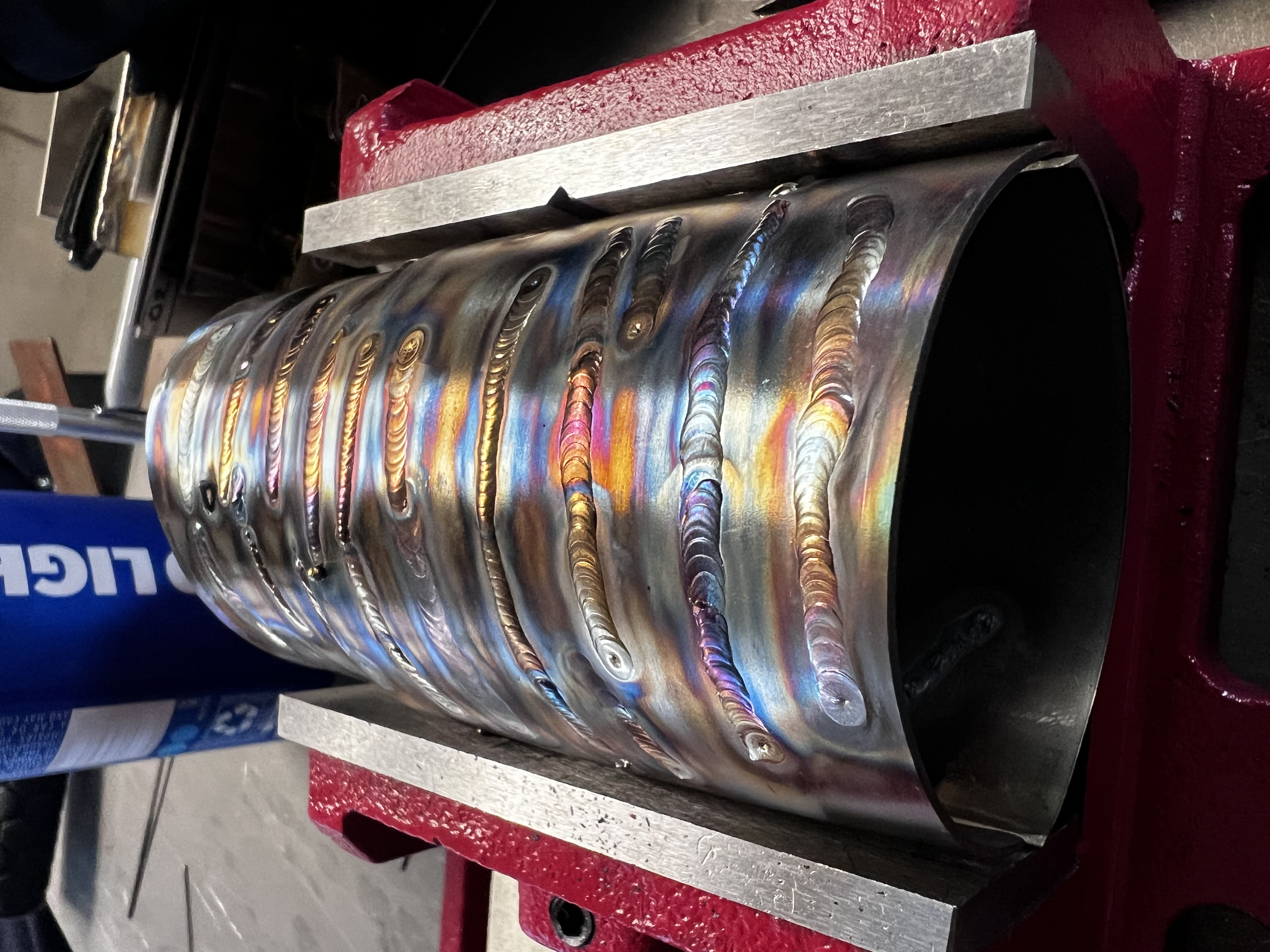

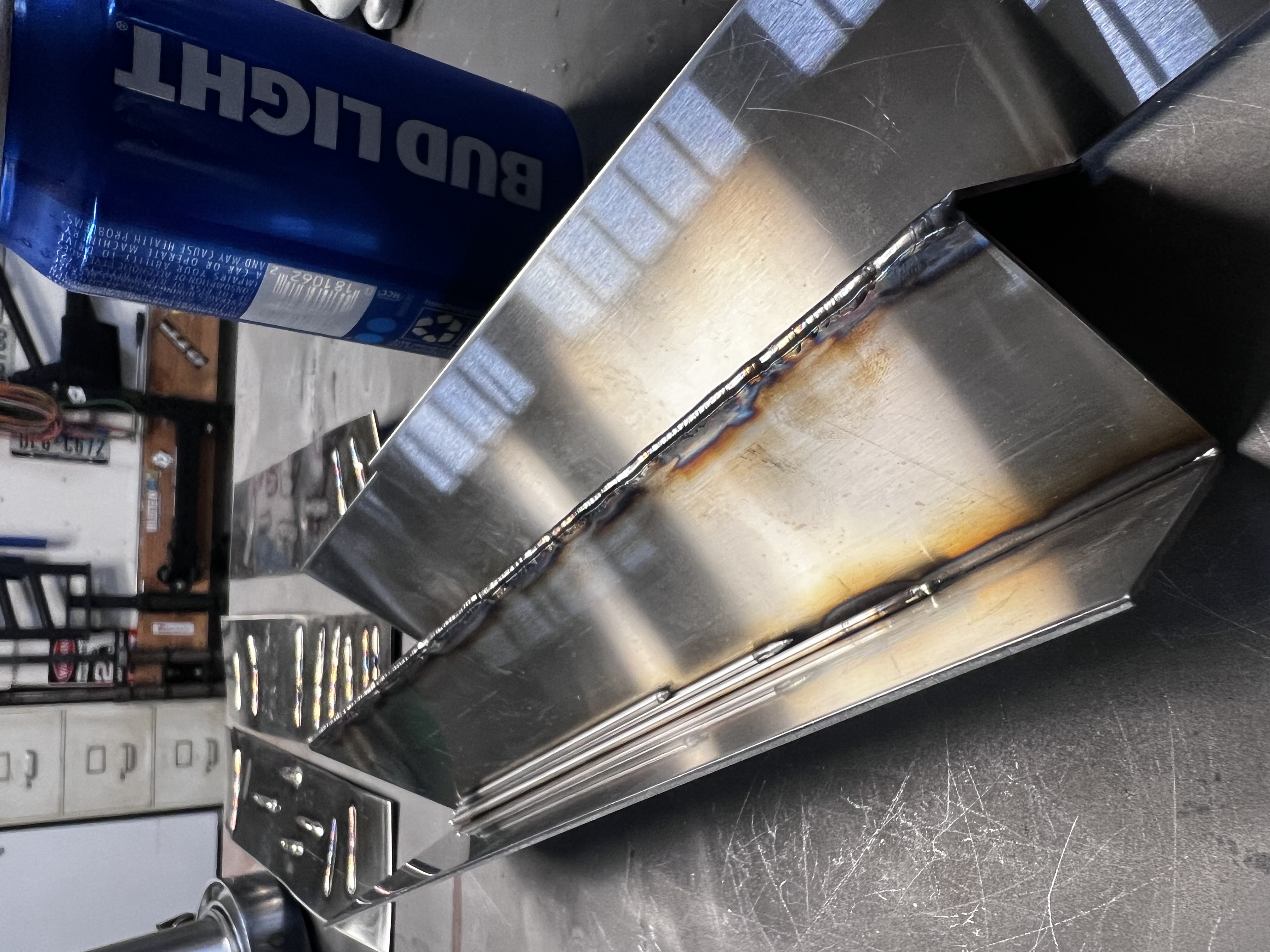

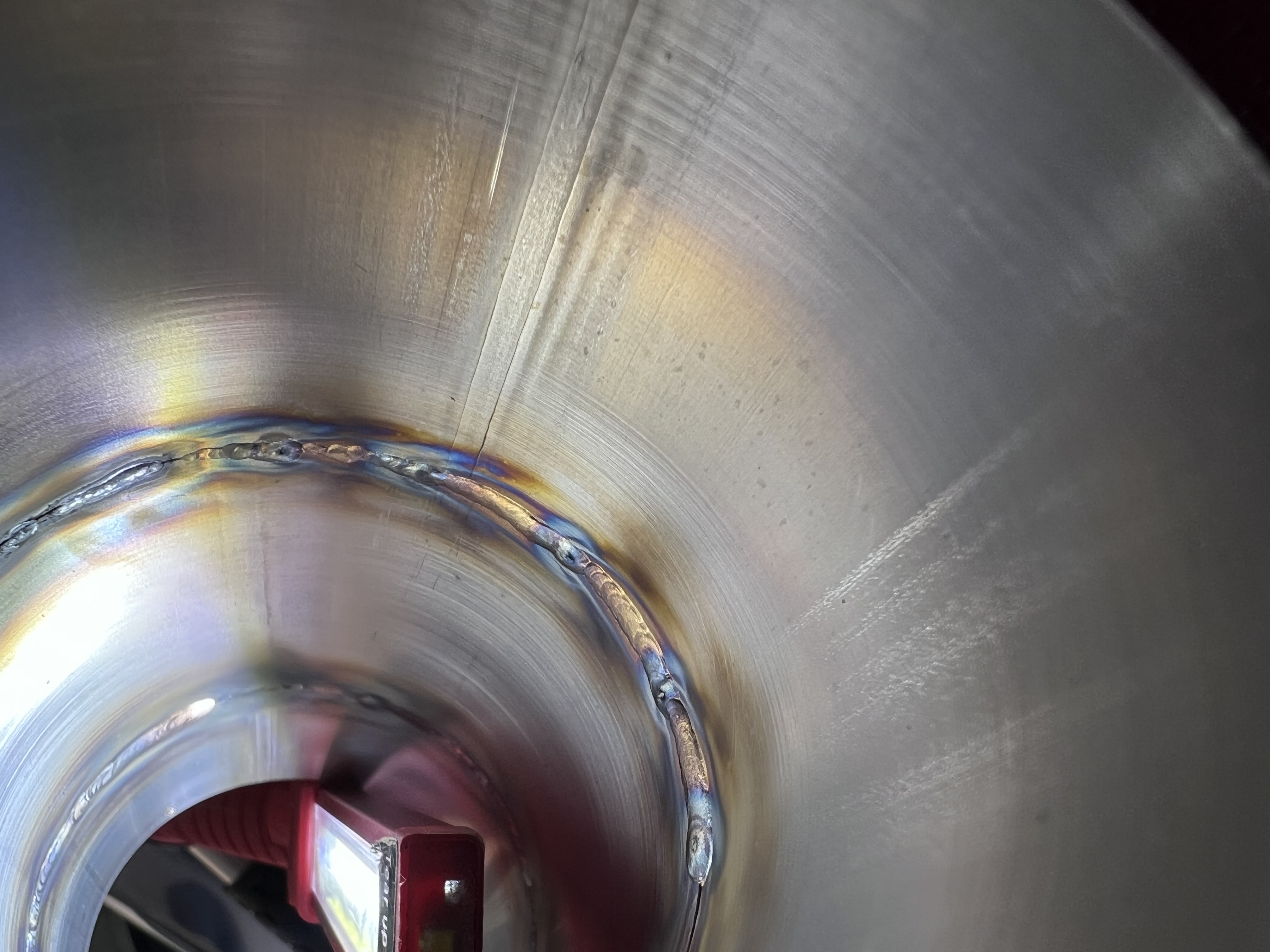

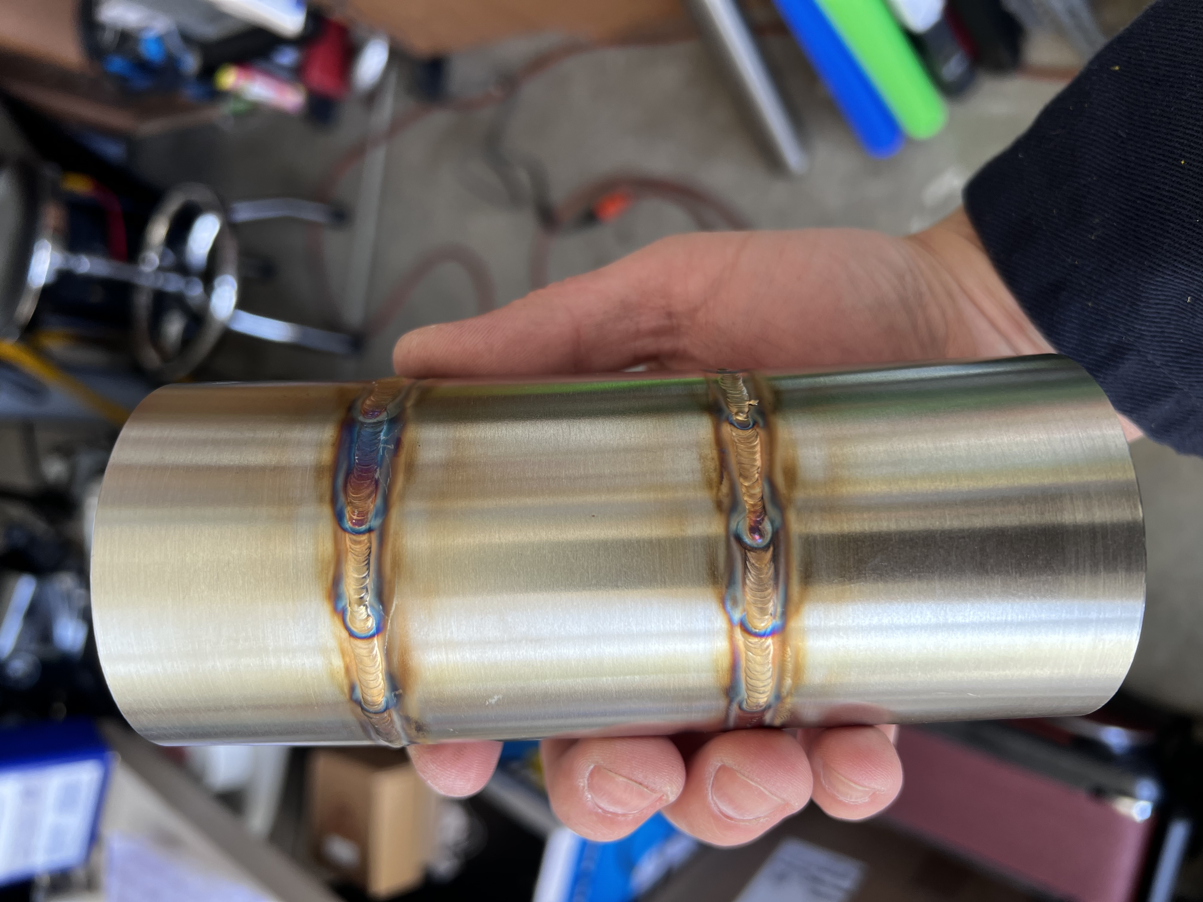

My first attempt at welding 3 pieces of 18 ga stainless tubing together. Wicked ugly but now I know what I will need to work on. Purged at 5 CFH.
- IMG_9448.jpeg (2.43 MiB) Viewed 36939 times
- IMG_9447.jpeg (1.75 MiB) Viewed 36939 times
- IMG_9442.jpeg (2.49 MiB) Viewed 36939 times
- IMG_9438.jpeg (3.17 MiB) Viewed 36939 times
good job. certainly getting there. the outside is better than some of mine and i've seen pro's do it worse.
thats really good fit up which makes things a lot easier. with those tacks i would increase the pre flow a bit so your not getting that black oxidized ring on the tacks. also i like to do a little swirl and drag metal across the gap/chamfer.
the purge could be better. one thing i like to do when welding short lengths is to make the gas exit holes around the outside of the tube. that way the gas flow is across the back of the metal not in the center of the tube. tin foil over the tube and poke holes around the edge, or a scrunched up ball of foil shoved in the end (yeah i'm that high tech).
Thank you, tweake! I will definitely apply your tips on the next run.tweake wrote: ↑Fri Mar 08, 2024 5:53 pm good job. certainly getting there. the outside is better than some of mine and i've seen pro's do it worse.
I spent hours watching Jody and a few other YouTube welders repeating the importance of good fit up and cleanliness. I figured those would be two less variables that I can eliminate to be able to focus on just the welding part.

The only critique I'd make about the 18ga stainless is to use thinnner filler wire. It will help reduce how much heat, how much weld profile you generate. Since your fit-up appears to be good, you shouldnt need much wire; just enough to prevent undercut on the outside surface.
Another trick you could do, is using the same wire currently, intentionally gap the butt joint by 0.030 (use some pieces of MIG wire off cuts to pack the joint). Do your tacks, pull the MIG wire, then run your beads with the ends capped and tape around the butt joint on the opposite half. As you progress around the circumference, pull the tape and acetone wipe any residue before welding. And be patient on 2.5" tubing and allow some cooling off time between runs (or upsize the cup, and crank up the volume on the Argon!). Stainless requires patience to avoid overheating and warping. Set all your gaps, make all your tacks, then tape everything up. Let the tube get full or argon before striking the arc. You'll get really good results this way.
You should get a nice, flush weld inside and out. With a small gap, its important that your travel speed is up to snuff so the weld doesn't sag inward. I use a slghtly higher purge CFM to help "push" the weld outward to avoid this.
One trick about purging: always weld nearest the "Argon-in" end. Have your vent holes up (even a slight angle matters). Argon is heavier than oxygen, so you want all oxygen pushed out and up to eliminate any presence near your weld.

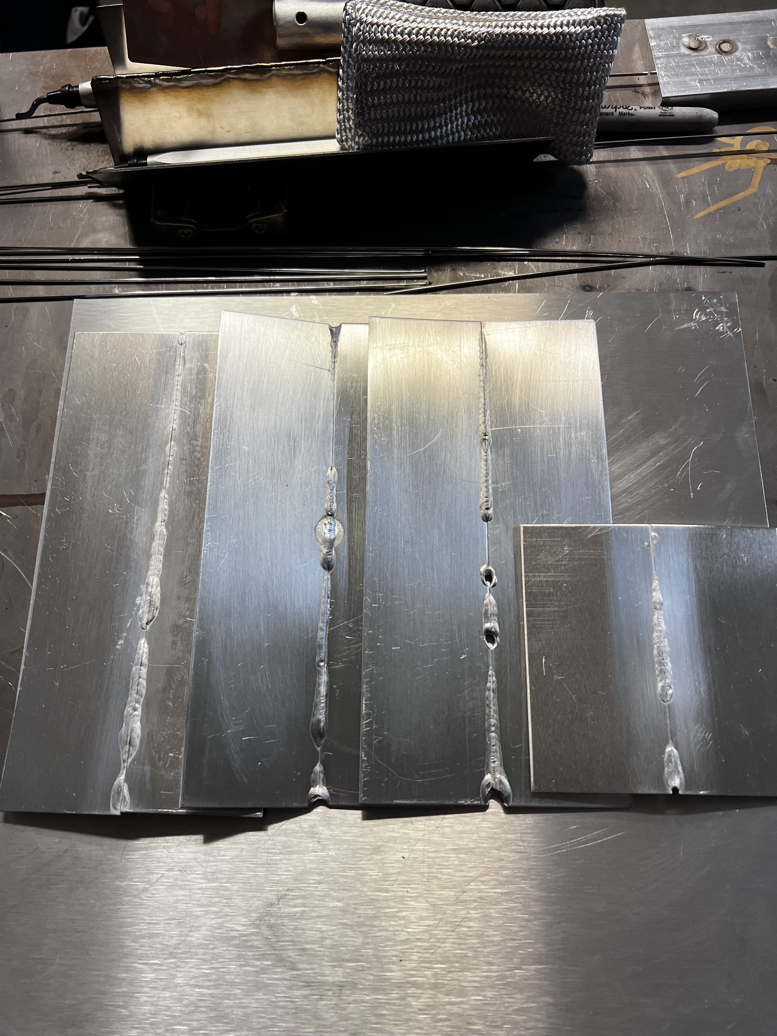

For your aluminum welds, just a bit more heat to help flatten out the weld. Your a bit too low on amps or a bit too heavy on your filler dipping. Less wire or more amps. Your travel strokes look really good overall and you're certainly putting in productive practice!!!

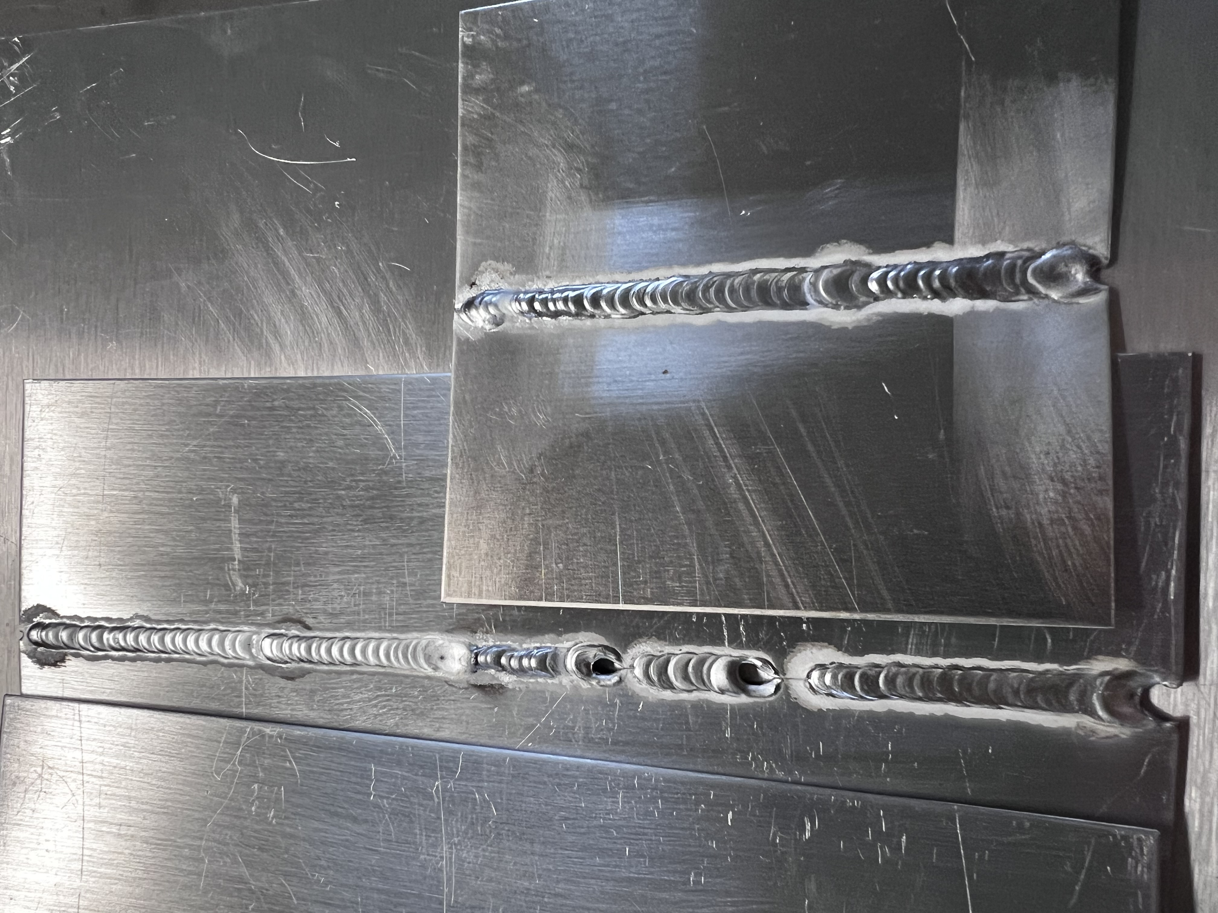

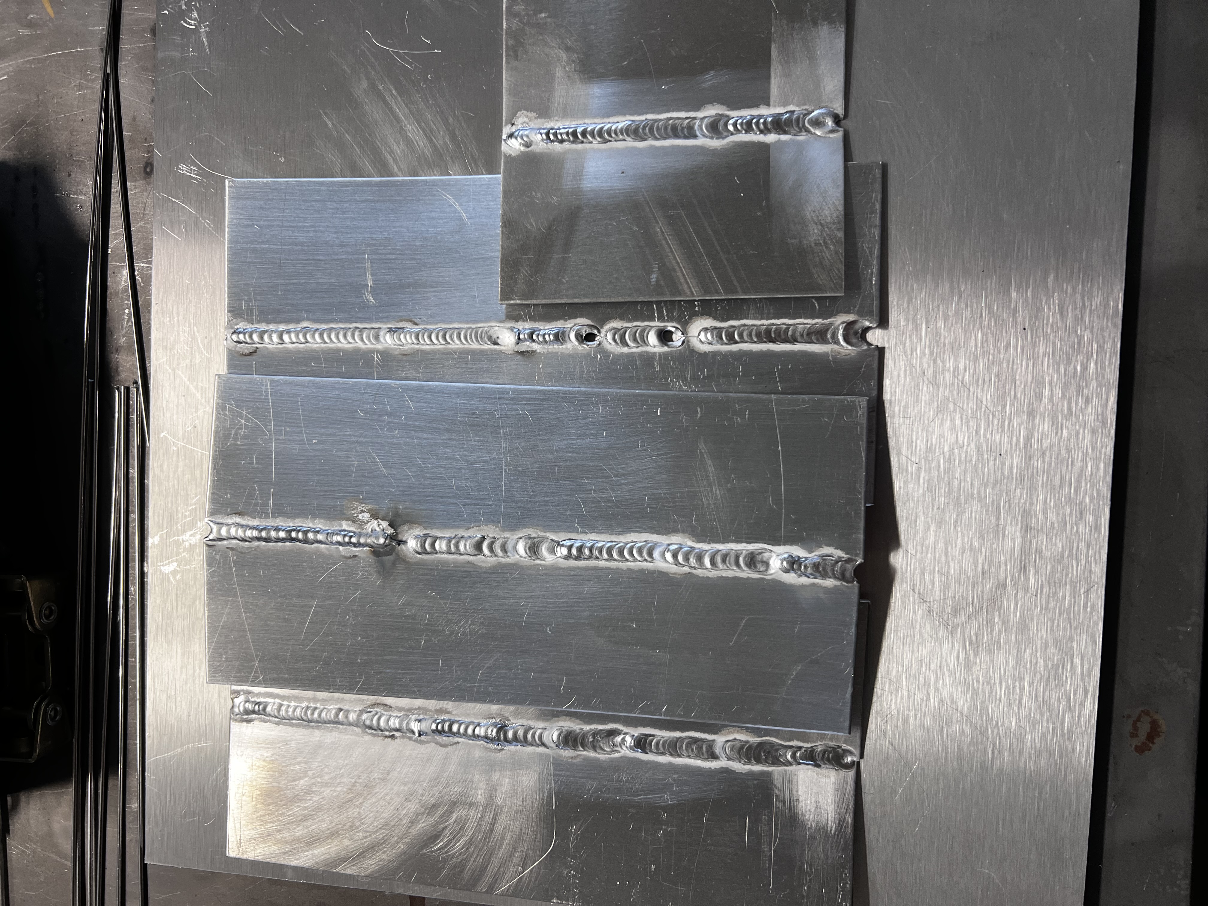

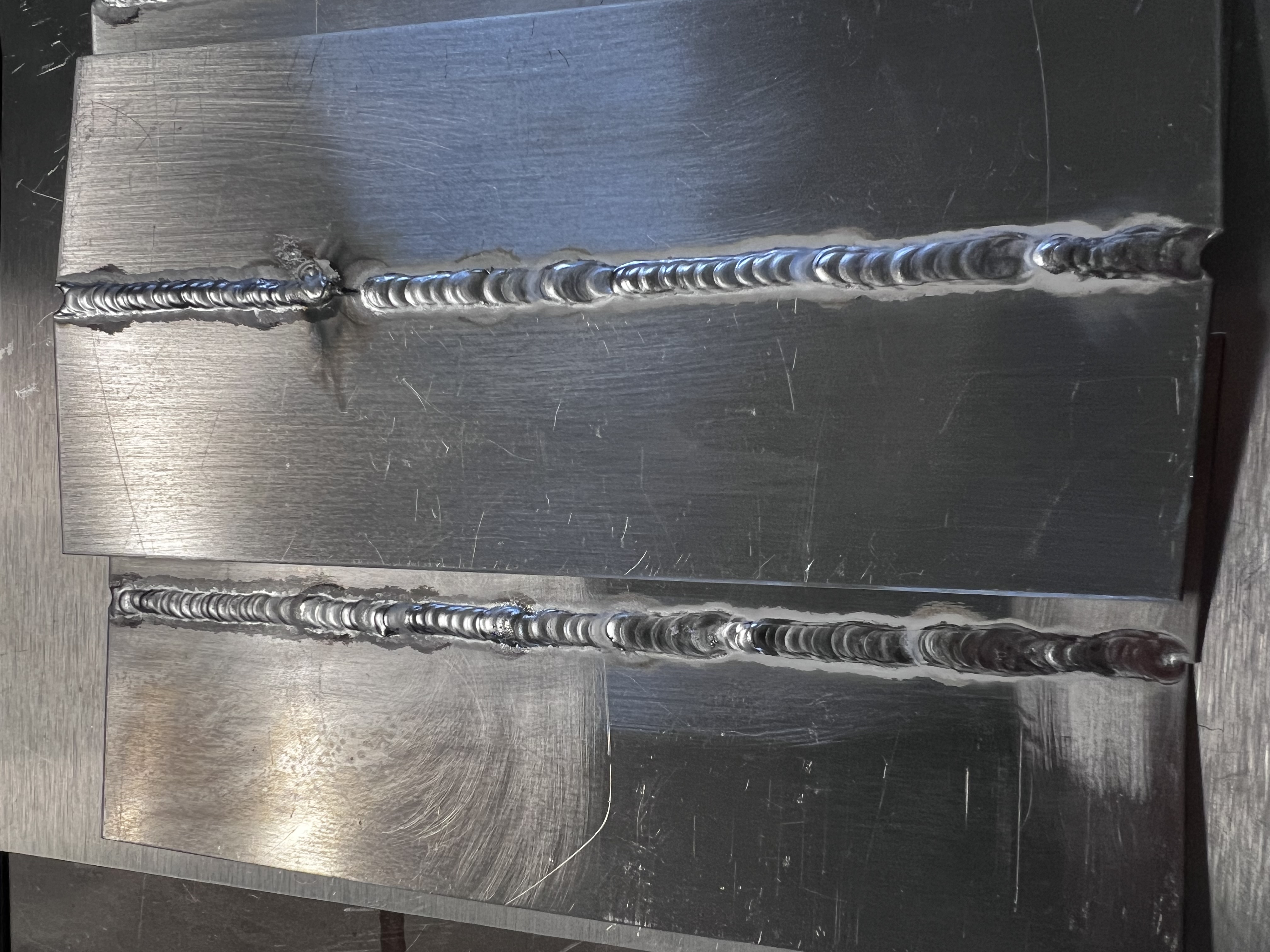

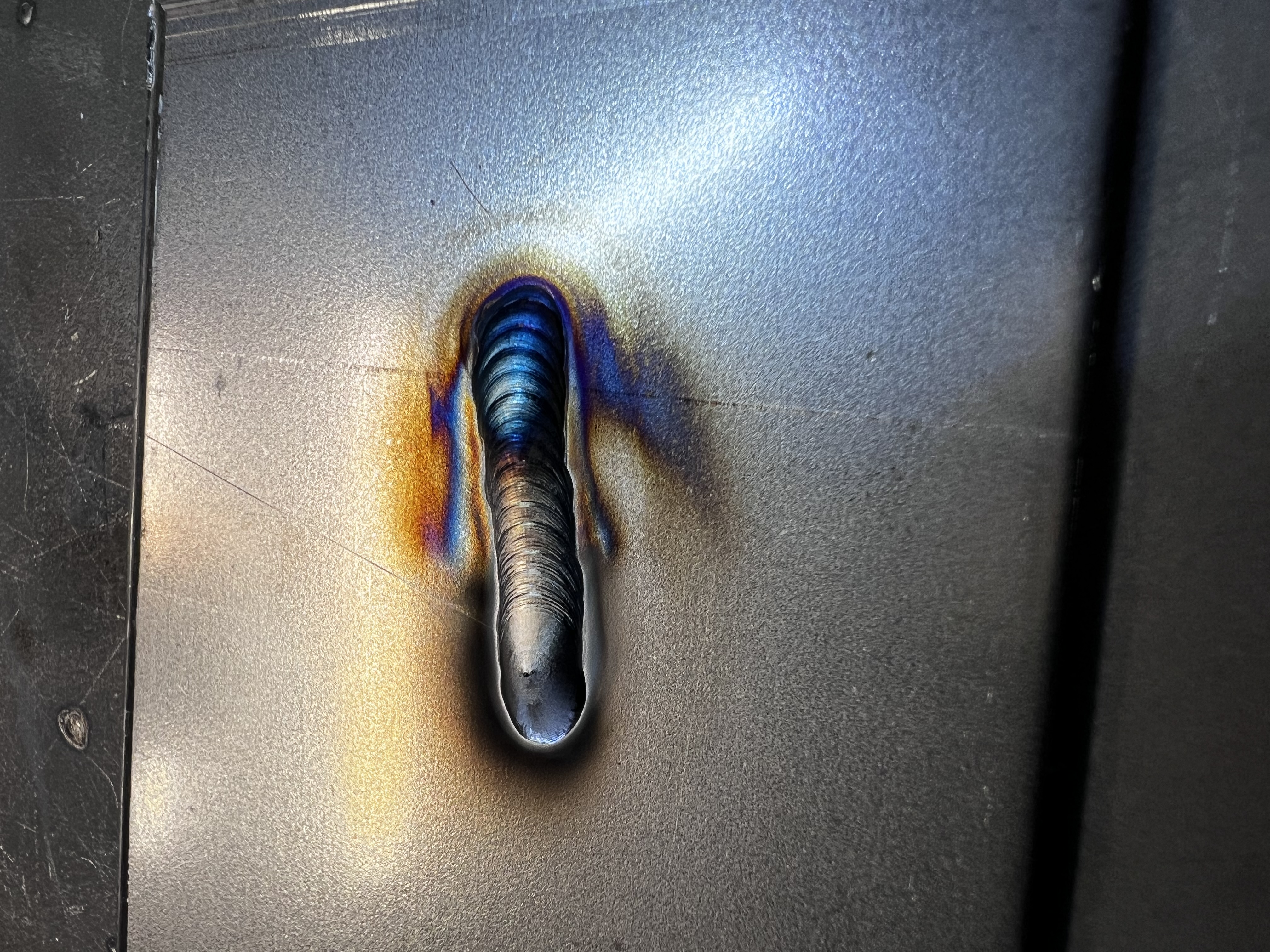

I didn’t catch your reply before I went at the aluminum again. This time a 1/16” butt joint @ 68 amps, #5 cup with 15 CFH, 3/32 blue and 1/16 ER4043.
Left to right. First attempt on the left. I popped a tack on the third try, lost my concentration and put a couple holes through the piece
I have a lot to learn and practice with aluminum ahead compared to stainless.

Thin aluminum is very tricky. You need to start backing off the amps as you approach the end to avoid the heat soaked material from burning back on you. Another trick is to add a larger tack at the end, weld to it, then back step to bring some of the tack into the weld.
68 amps is also tricky. It’s too much once you get going, it’s probably a bit low to start. If you have a pedal, set the machine to 80 so you get a puddle a bit faster, then as you go, start backing down the heat with your foot. You will get much better control with varying the heat than with a static setting.
Overall, pretty OK work!
Got it! I’m terrible at tacking aluminum. I’m on a pedal and going to crank it up to 80 as soon as I get back home later.cj737 wrote: ↑Tue Mar 12, 2024 8:00 am Thin aluminum is very tricky. You need to start backing off the amps as you approach the end to avoid the heat soaked material from burning back on you. Another trick is to add a larger tack at the end, weld to it, then back step to bring some of the tack into the weld.
Overall, pretty OK work!![]()

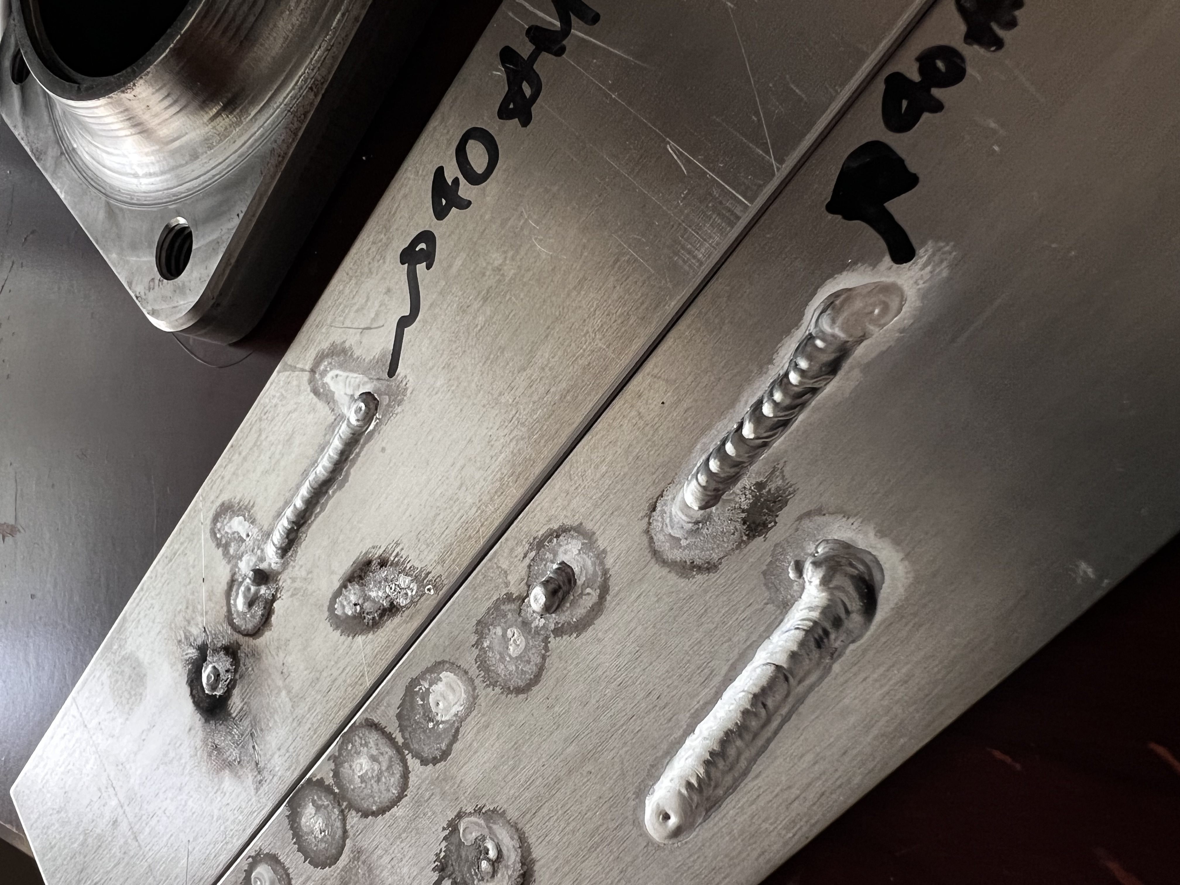

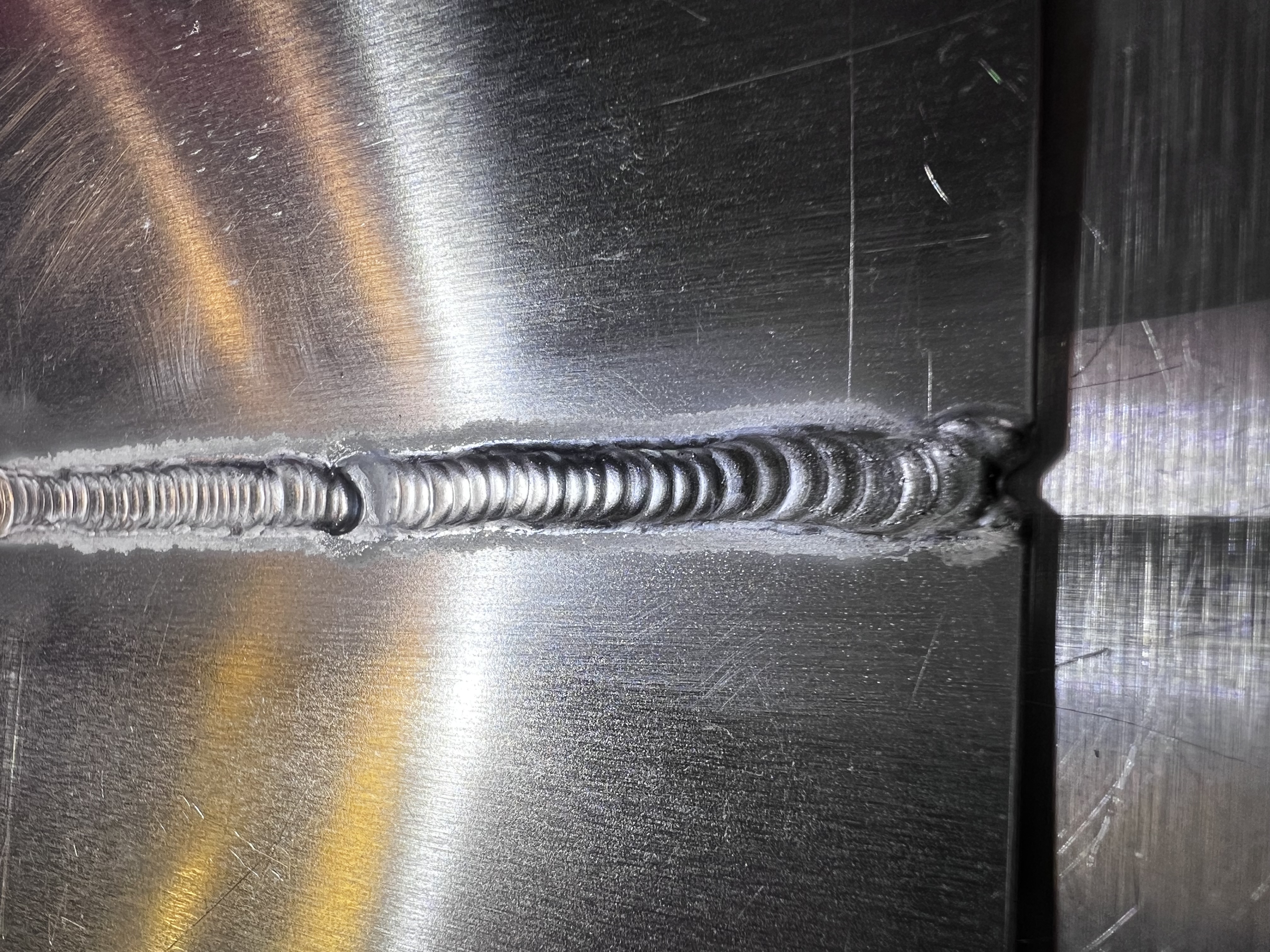

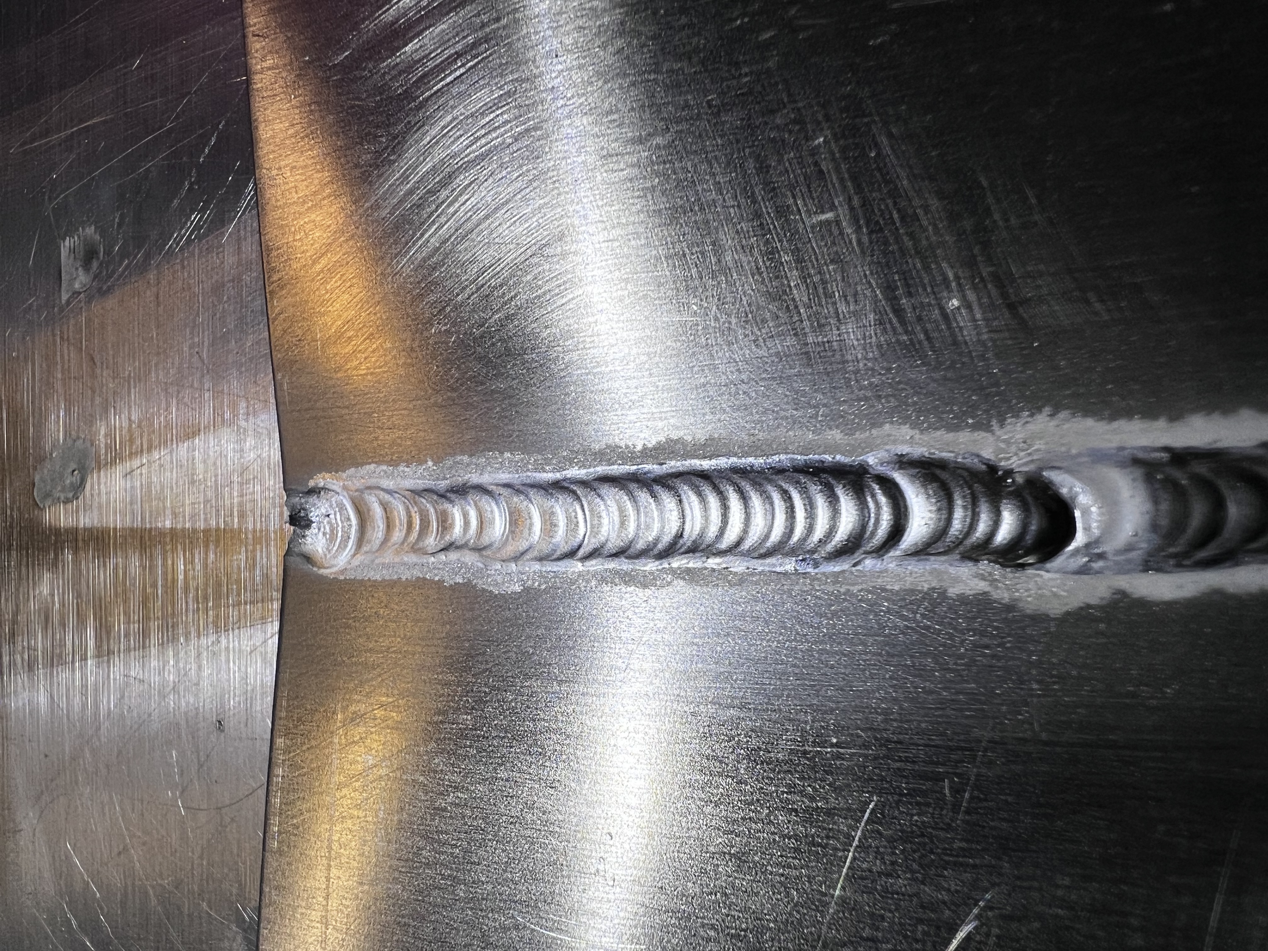

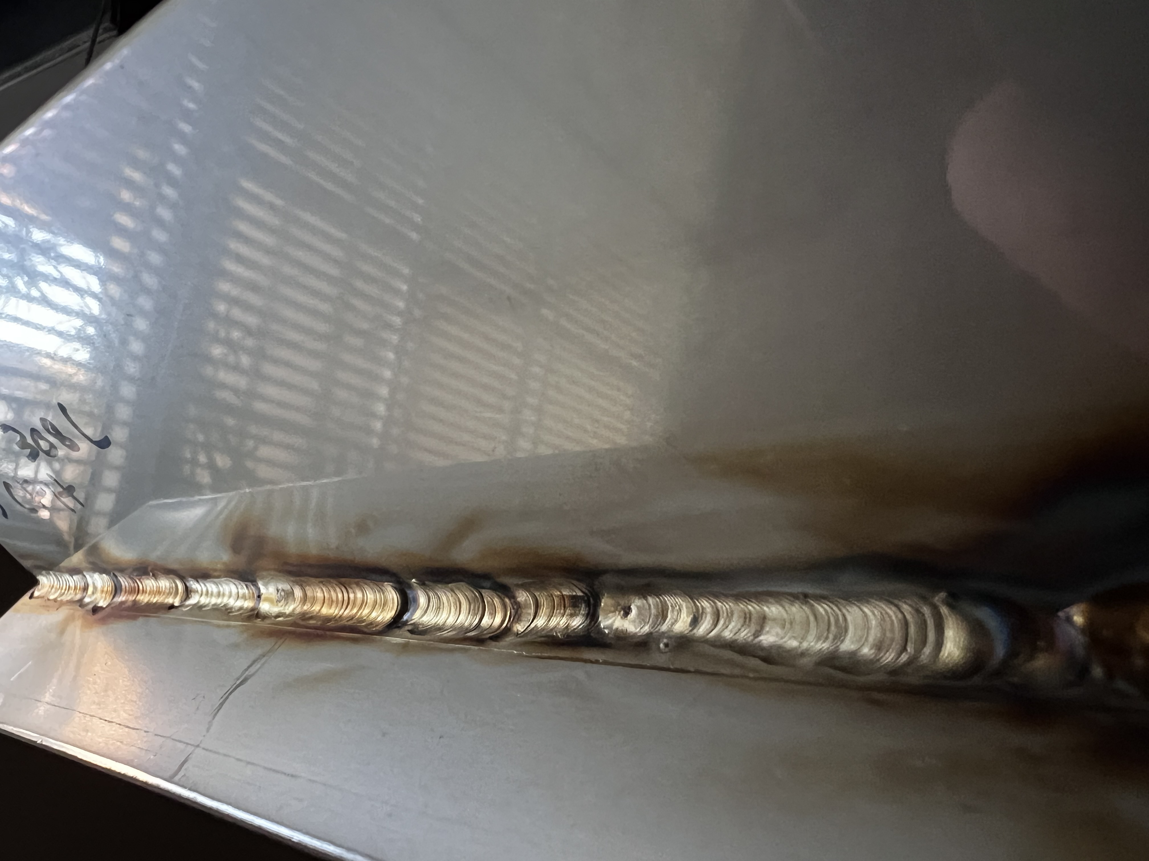

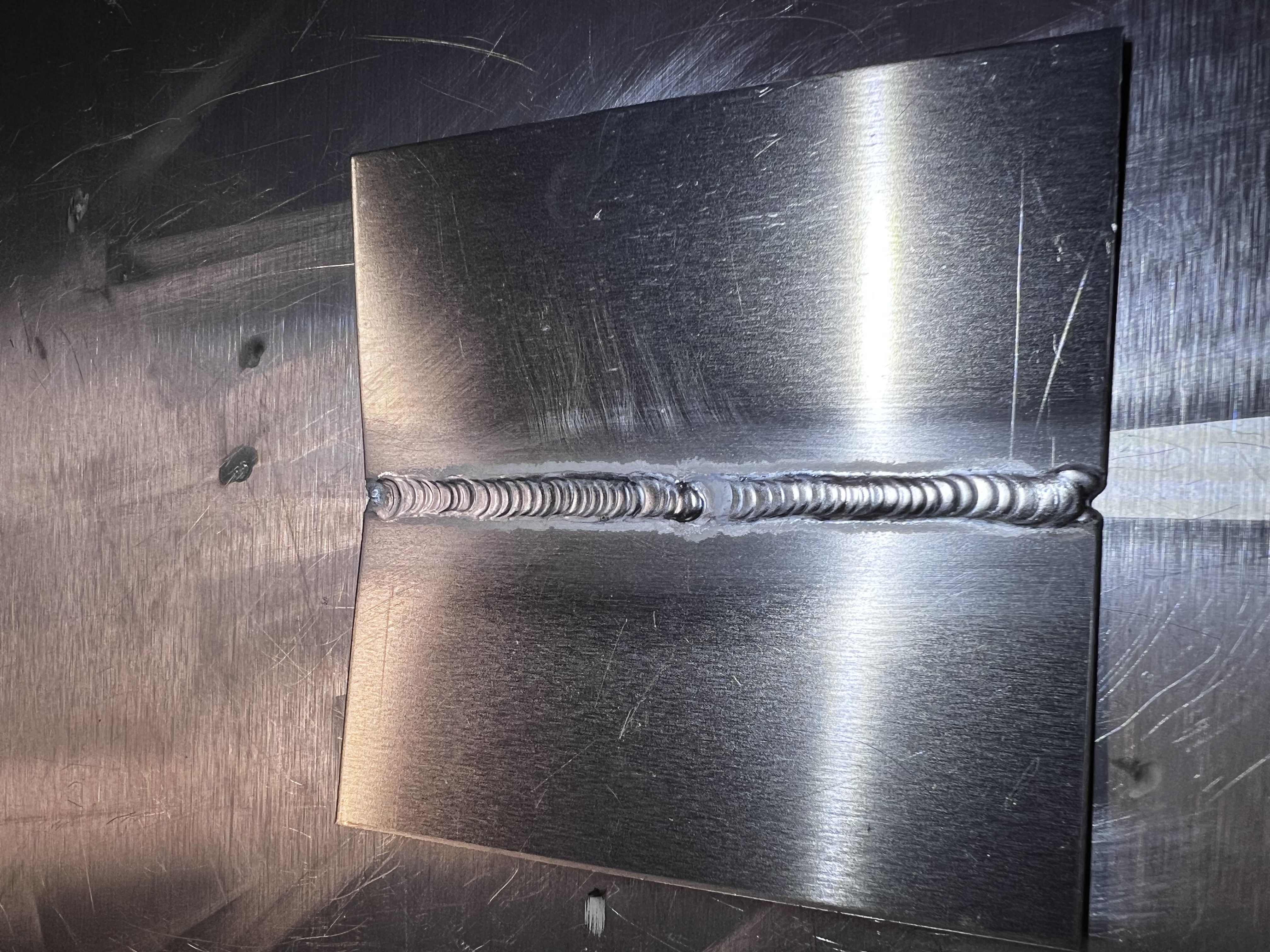

I couldn’t edit the earlier post from today but here’s the result.
Padded a few beads at 80 amps, ~35-45% balance and ~120 Hz then tried another butt joint.
Feels much more fluid and controllable @ 80 amps but I definitely need to practice running beads to nail down my puddle width and tie-ins. I’m sure there are other things that my amateur eyes can’t see.
I broke the weld into two beads to practice my restart as well.
