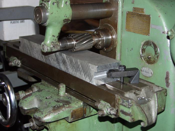

I've highlighted the key words here. As I have said before, the mill is stationary, this is not an end mill, this is what is known as a plain mill. You'll need to use your imagination here, but this is the type of mill you would use.GrundleJuice wrote:I can't understand how a mill head and or table that is not constantly moving could cut a tube to fit against another with a compound curved outer surface. I'm not a mill operator by trade so maybe it's just ignorance on my part.
Imagine if you will that the mill stays stationary, but the end of the bike tube can rotate or move in any direction, it's up to you to fixture it. with the tube held to the table on some type of fixture, you move the table towards the cutter and it essentially mills a notch into the end of the bike tube to fit another bike tube which you weld onto the side of.
- using plain mill on a horizontal milling machine
- slot-slab-mill.jpg (53.17 KiB) Viewed 2292 times
Yes, you use a mill/cutter that is the size of the tube, therefore the shape you mill into the end of the tube fits on the side of the other tube you weld it to.GrundleJuice wrote:Wouldn't notching the downtube to fit that head tube require a shaped cutter
Go back to the link I posted above, in the 2nd post of that thread you can see how you would mill a tube end to weld to another tube side.

cj, indeed you don't. However if you want the best tool for the job it is the preferred way many professional bike builders do it. I agree and mentioned above, a hole saw works, but pales in comparison to a horizontal mill with a good jig.cj737 wrote:You don't need a horizontal mill for bicycle tubing.
I bought that Nichols mill in the pic on Ebay shortly after Ebay was started for $17. People were still trying to figure out how to list and price items...the auction started out at $0.99...
That said, not hard to find a horizontal mill for a couple hundred bucks if one looks. They're not in high demand, and one reason bike builders like to use them.
