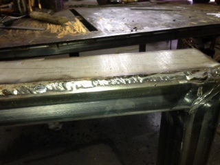

Also, here's one of the cart racks I made in the spring after my stick class. These racks hold 400 lb. rolls of film for bagger machines. 2x4x1/4 316 SS for the arms, 4x1/4 ss flat stock for the extensions, and the risers were 1/4" SS diamond plate (this one was leftovers. Of the 5 I made, the other 4 were just regular 1/4" sheet because the planner freaked out about the price of the diamond plate when I said I made the first one out of it haha) cut with a water-cooled plasma cutter using Solidworks (I dunno how to do that--had to get somebody to put that in after I did basic layout. Some of the stuff they make on that our general maintenance department is incredible). Used 1/8" and some 3/32" 316 rods (right? You use the same number rod for SS that is the metal? I don't remember exactly...). Braces 2x2x1/4 angle.
A little rough, but they haven't broken off and let a roll go on anybody's knees yet....
first pass
first pass
first pass.jpg (27.73 KiB) Viewed 441 times

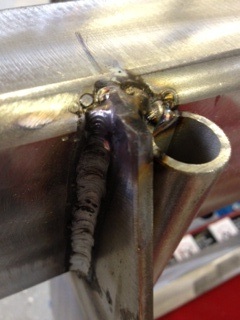

fillet for brace (ignore the booger on top and booger for allen wrench holder)

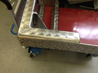

And the finished product:
finished product.jpg (45.35 KiB) Viewed 440 times

That cart looks like nice work!
