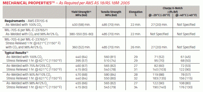

In my opinion, the manufacturers published material on the subject could be used instead of smacking things with a hammer.
Although hammers are fun
Here, Lincoln has listed the typical as welded: yeild, tensile, elongation %, and charpy V notch.
(note: the actual requirements are pretty much identical)
