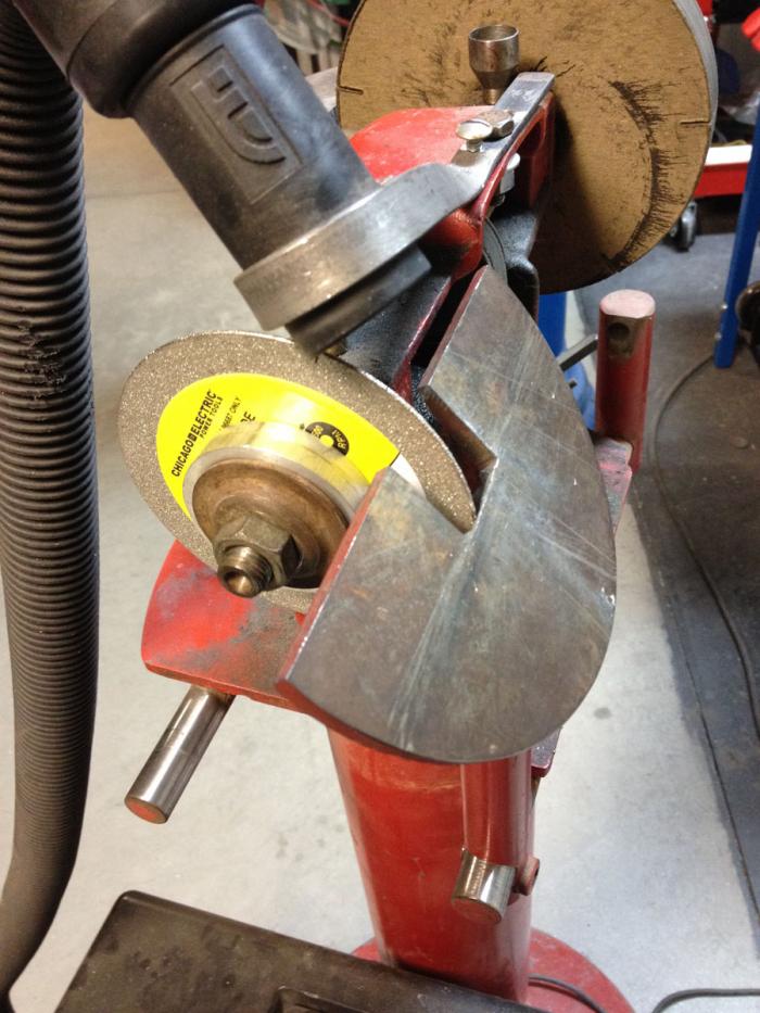

Sharpness, sharpening angle, smoothness, stickout. It's all over-emphasized.
I've passed x-ray with the most boogered-up tungsten you can imagine.
It only gets important in very thin sections... The precision required by the material dictates the precision of the tungsten grind, and I find stick-out almost irrelevent until it exceeds your gas coverage.
Don't get me wrong; Knowing how to properly sharpen a tungsten has value... with the right sharpen, I can weld 24 ga with a 1/8". Not my preferred situation, but one must adapt to the circumstances one is thrust into, to make that paycheck.
After years of trying to produce artistic welds using half-assed technique, I've finally come around to trying to do things right. I attempt to get good fit-up, clamp my pieces in place, clean my base metal, use sharp electrodes, see what I'm welding (that's a big one), make sure I'm tying the two edges together, etc. The results are generally better. And since my option to making beautiful welds is to grind them when I'm done, I have a lot invested in producing beautiful welds.
When I was researching how to sharpen tungsten electrodes, I happened upon a BBS response from someone who sharpens his tungsten on the side of his grinding wheel. I'd like to thank that fellow, if I could only remember where I found his comment. Now, sharpening tungsten eats up grinding wheels, so I've sandwiched a HFT diamond saw sharpening blade to the side of my grinding wheel. And I hold my 3/32" electrodes (which I usually use) with an old drafter's clutch pencil.
I'm glad Jodie just did a video on sharpening "Tungsten" it's always been a issue for me as to what's right and what wrong?? So I guess what works for your situation is the way to sharpen!! How ever I was wearing out grinding wheels on my "home-made-grinder" (made the grinder when I was young-been a lot of years ago!!) SO... I saw a video on "Youtube" about using the diamond saw blade grinder wheel from HFT... It's only $9.99 and I thought the price is right! So... I made an adapter for it out of aluminum to adapt it to the 5/8's shaft and it works good! I just turn it by hand and pivot it away when I run out of wrist/twist! A picture is worth a thousand words..... O'Yes... the vacuum cleaner is suck up "Thoriaded" dust just incase it's bad
