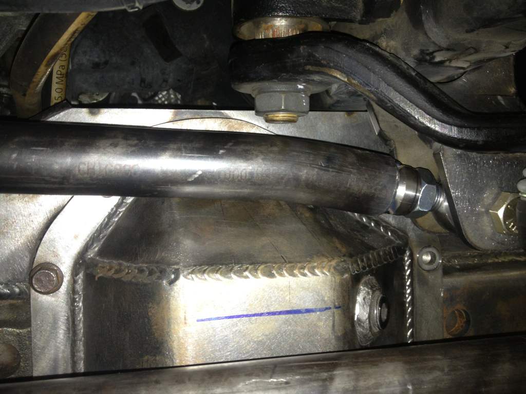

Jody you had said in a video you were trying to figure out how to get spaced ripples the stack of dimes effect. I think we have figured it out. Check these out and let me know.

bluewave wrote:Jody you had said in a video you were trying to figure out how to get spaced ripples the stack of dimes effect. I think we have figured it out. Check these out and let me know.
Steve
Ok. that looks pretty cool. now i am curious about the technique you used.
jody
Would like to give credit where its do. Vick at VKS Fab is the one doing the work.call my style "low & slow", lowest wire speed possible and slow hand speed. Its standard short-circuit mig, one constant bead, no trigger welding here. Dependent upon what type of joint I'm welding I either run "up and back" or "E's" motion. Also, machine wise I run a Lincoln 256 with .030 or A Snap-On MM250 with .035 or .040. With the shop enviroment aroud 40cfms of 75/25

bluewave wrote: call my style "low & slow", lowest wire speed possible and slow hand speed. Its standard short-circuit mig, one constant bead, no trigger welding here. Dependent upon what type of joint I'm welding I either run "up and back" or "E's" motion. Also, machine wise I run a Lincoln 256 with .030 or A Snap-On MM250 with .035 or .040. With the shop enviroment aroud 40cfms of 75/25

Everyone of those interruptions or dips between the dimes is a stress riser. But those risers might mean very little in a negative sense ... especially if there is good fusion. Of course, if the process is running a little cold, then each dime would augment the risk of fusion difficulties. The lengths of the fillet weld legs measured at the dips between the dimes would give us the minimum fillet size. My guess is that the dimes pass will take longer to run than a straight continuous spray pass.

I agree. I've made the "stress riser" argument discussing TIG welds, particularly socket welds, where walking the cup lends to pretty "tractor tracks".
I've just never seen it analyzed, to see if the common-sense notion of a smooth, uninterupted, even weld and weld interface is actually measurably stronger then "stacks of dimes". I doubt the weld interface is the weak point, if the "dimes" rise and fall smoothly along each leg of the weld. I would sooner suspect low penetration at the "colder" parts of the joint, the space between the larger puddles.
I question it here because the poster referred to "the lowest wire-speed it can tolerate", meaning relatively low weld current, and potentially low penetration. I saw what looked like 1/4" structural parts in there with "pretty" on them, where "strong" is the priority.
If there's been an analysis somewhere, I've not read it, and would be very interested.

Yes ... ensuring fusion is important. If the voltage is not fine tuned on the wire processes there is the risk of lack of fusion.
The drawing may require a minimum sized weld. So those fillet legs, if deposited with dips, the legs would alternate longer and shorter. So if the shorter one is sufficient, then theoretically the longer legs would be excess weld metal.
Perhaps on this string, we are not worried about those calculations and maximizing production, but we are simply discussing the different welding techniques to realize the 'dimes' appearance, for whatever reason.

I've reconsidered the use of the welds in the pictures posted. Many, such as on the differential cover, need only be oil-tight, as they're not primary structure. Others, like the link-bar brackets where I noted 1/4" material, are primary structure, but I've seen them done with 1/8" with adequate strength. These may be built with a high enough safety factor that "blazing it in" isn't needed to have more than enough strength.
Your point about matching voltage and wire speed for "ideal" current is well taken, too. The welder clearly knows what he's doing, as evidenced by the consistant beads, lack of any apparent undercut, underfill, or other obvious flaws anywhere in the pictures.
It just raised in me a curiosity about relative strength. Hell, I maybe thinking it backward. The "low and slow" approach allows more heat time on any given location, which may balance penetration while allowing the silicon (appears to be an -S6 wire) more molten time for scavenging.
