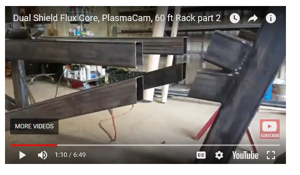

Good video's, I don't work with the big fab projects like JD does, have in the past, but do like to watch how he fabricates.
Also by cutting the splice plates to fit over the rec tubing it doesn't change the over all length
Was curious why such a short section had to be spliced?

If you noticed, the video only shows 40' of the 60' build. I think the short section is shown with an extension (10''?) not shown in the video, at the far left of the "assembled outside" image. There also seems to be a bolt-up on the last 10' section on the right.
Speculating, for lack of image quality.
Steve

In answer to your question. If you enlarge the aerial shot at the end of the video, it looks like the rebar rack is built in three sections for ease of transport, so the short vertical section you see was added onto with two more bays.
