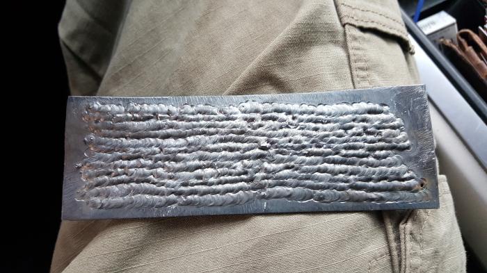

My main issue is when do I dip the wire and is it at the base of the puddle. All I keep getting is little balls that form up and it looks like a caterpillar Im not getting those nice dimes like jody. Here is a pic of my three day and I was using the lay wire technique. I was just making a u shape around the filler wire.

And what size filler rod? 14ga is pretty thin stuff. If you are getting "caterpillars" then you're adding too much filler or not using enough heat.sambo1985 wrote:I forgot to mention this is 14 gauge mild steel in the pic

As I look at the picture, my impression is too much filler, and too long an arc length. The edges of your strings are "undercut" which is a result of under filling, or too wide a heat zone. On 14ga I'd be using a small cup (#5 or #6) a 1/16" tungsten, and probably a 1/16" wire. My cup would be in contact with the plate, my tungsten just barely sticking past the cup. Then I'd feed wire/lay wire and try to almost touch the puddle by manipulating the angle of the torch, pushing the puddle.
Watch for the edges to burn in, and when you see a bit of keyhole at the front of the puddle, you know you need wire. Minimize the keyhole, but you need to travel the torch to require more wire. That's what causes that "lay dimes" look. Those are the freeze lines of the puddle caused by the torch traveling. If your dimes are elongated, you're short on wire, too stacked up like a caterpillar, too much wire.

3/32 wire on 14ga is just too darn thick in my opinion. Maybe for making a fillet weld or bridging a gap, but no way for a stringer bead.sambo1985 wrote:I switch between 1/16 filler and 3/32 filler. And using same matching size of tungsten for filler
It should be plenty, provided you don't feed too much wire in too fast.
Bear in mind, adding filler cools your puddle. Get the puddle to right heat so as to weld but not blow out, then suddenly here comes a big wad of weld wire. Blam-mo! Puddle gets cold. So you have to "work" that added metal into the surrounding metal by raising the temperature. Then travel, then add, then repeat. It's just downright "it all depends" on the circumstances.
Just practice a little bit with 1/16-1/16 on 14ga using basically the same amps. Travel further between adding wire. Come back the other way and add wire faster. Take notice of the differences. More wire=more heat required. Faster travel and you can get away with more heat because you aren't staying in one place.

Try lowering your amps to 60 and run it. Then try 55. Then 50. You'll find a sweet spot for your speed and wire sizes.
