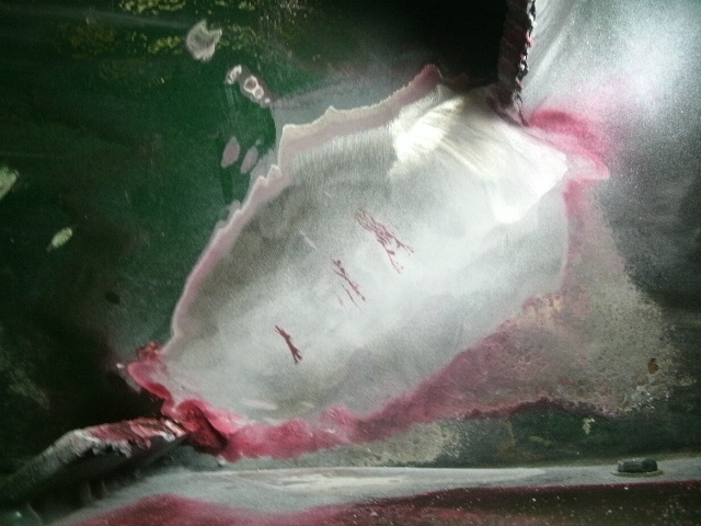

About a month ago I did a cracked Chevy truck bell housing.
Basically did just like Jody just showed about amps, slow puddling, stop drill, cleaning action, etc - except I've never dye checked anything and thought that was an AWESOME tip.

Steve I got a question for you then, is there really any noticeable difference in the standard kit vs the nuclear kit that dynaflux makes.Otto Nobedder wrote:By the way, if anyone is interested in discussing dye-penetrant NDE, I've accumulated a lot of experience with visible dyes like Jody used, including in ASME code applications, and have more time to discuss it than he does.
I'm pretty sure the "nuclear" kit is going to be a UV penetrant, rather than visible. Since it fluoresces under blacklight, much smaller traces are detectable, making UV penetrant quite a bit more sensitive. It's more expensive in several respects, though. First being the cost of the materials. Second, of course, is a powerful enough blacklight... A good 50W longwave will set you back $400 or so, and replacement bulbs for ours were $116 last time we bought. Third is the time and material to black out all light from your test area, if your piece is too big to move to a dark room.
On a side note, don't EVER blacklight anything in the company rest room... You do NOT want to see what glows in there...
I should add, I don't use UV penetrants at this time (we have the blacklight for oxygen-clean checks), as the visible is more than sufficient for what I'm testing.

Well that would make sense however the dynaflux kit doesn't use UV light and it had same instructions for both. The only difference I found on the website for them is one is flammable and other isn't. They didn't list any other details on website which is while I enquired about it.
Here is link to kits on there site
http://weldingsupplies.dynaflux.com/vie ... eck-i-kits
Gonna try to get company I fix polaris housings for to spend money to use this stuff. I never thought about using it really, after watching Jodys video thought It would be a good idea to make sure we do get all the cracks. Have used machinst blue in past to help make some cracks more visible.

It may just have a few diferent ingredients to allow its use in a nuke plant. And it will have traceability for record keeping. Like batch numbers and such. They make a nuke grade duct tape too. The glue has a few diferent chemicals in it so that it is "approved" for use by the nrc.
A study of the MSDS for the two varieties shows the penetrant is the same in each kit. The developer in the nuke version is much higher in VOC, perhaps for a much faster dry time and much less residue to clean.
The cleaners are even more dramatic in difference. The non-flammable is methylene chloride, while the nuke version is essentially light Naptha.
In both cases, the "nuclear" is what I use. Sounds like marketing to me.
