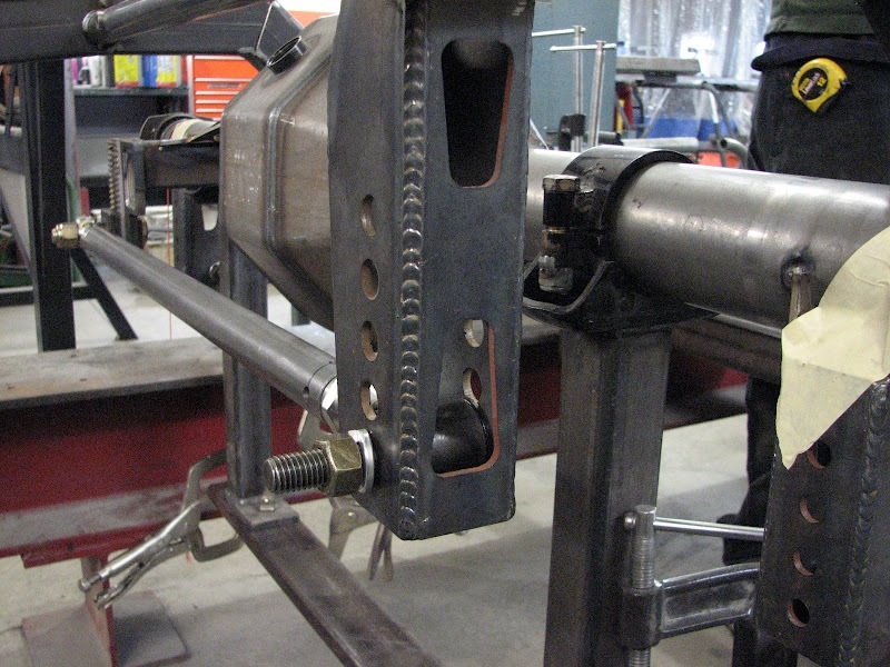

All right, this didn't work quite as intended... I hadn't considered that I'd be welding 5/16 stainless in place, so it's not a stack of dimes at the heat I was running, and the TIG was done on the bench, walking the cup...
I'll have to put up a side-by-side bench comparison of something with similar heats and NOT walk the cup...
- GEDC0617.JPG (172.08 KiB) Viewed 4106 times
I personally put larger pearls in a weld using technique, and less about wire speed or amps/volts.
I've done it on heavy work wayyyy up in the amperage with spray transfer. Sometimes it's just not possible to to a real heavy stacked look because everything is so hot.
The 'secret' is allowing the previous puddle to solidify enough that you can wash part of the new one over it. This also helps tie in the toes and makes everything fuse nicely.
I'm sure the stacked technique can be achieved using any letter of the alphabet, but I personally use a step and back then 'C' motion.
Something like:
C←•--C←•--C←•--C←•--C←•--
Where the bullet point denotes a pause in the root (slightly ahead of the puddle), with a rapid washing movement with the arc for the 'C', and quickly forward again deep into the root for the new deposition and cooling of the previous puddle.
In "shop talk": "It's a step and pause technique with a fancy C shaped back wash to plant a pearl stacked on the previous pearl."
Hope this helps some newbs and maybe some non-newbs.
