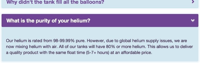

Balloon gas has a certain percentage of oxygen in it. It's there so you don't die when you breath it in to do a Donald Duck impression. I think that would cause more trouble than it's worth.
The MSDS for balloon time helium that I saw listed 100% helium - doesnt mean there aren't blends out there, but it's what I saw.
I showed a friend how to tig aluminum with a helium tank he picked up for party balloons - it was a high pressure tank from a welding store, but he did tell them it was just for balloons.
Wish I had some helium, I'd try some blended just for fun
Edit: I just saw that balloon time helium is now going to be mixed up to 20% air due to the shortage.

This is going to be one of those YMMV things- I've read conflicting notions, one that balloon grade is mixed, another that balloon grade (meaning not certified) from the LWS is pure helium that has not been tested for purity. Good to know that party time is a mix. It'll come down to asking the LWS "is this pure helium, or a blend."MinnesotaDave wrote:mixed up to 20% air due to the shortage.
Dave
aka "RTFM"
aka "RTFM"
Sunds about right - this is what party time said about it:Artie F. Emm wrote:This is going to be one of those YMMV things- I've read conflicting notions, one that balloon grade is mixed, another that balloon grade (meaning not certified) from the LWS is pure helium that has not been tested for purity. Good to know that party time is a mix. It'll come down to asking the LWS "is this pure helium, or a blend."MinnesotaDave wrote:mixed up to 20% air due to the shortage.
