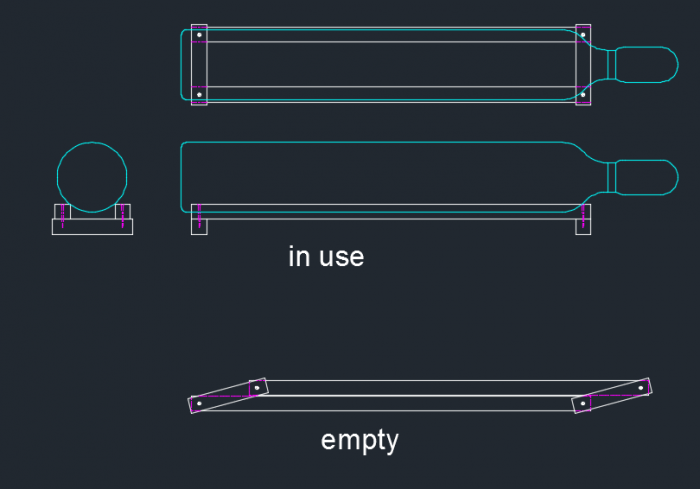

Hey there,
I've got a standard pickup truck and I'd like to be able to transport a 120 CF cylinder of Oxygen and exchange it for a 120 CF cylinder of Argon at a local shop. I talked to the shop and they are willing to do it, but I have to get the cylinder there and back.
I can't strap them up right because they would be too top heavy, I imagine. So what other solutions are there? Do I need to wait till I get a back rack or something like that which will attach to the bed and allow me something to strap the cylinder to? Thanks for the input.

by maker of things
I copied my father in law and screwed (4) 2x2 boards together to lay the tanks on so they don't roll. When not in use it collapses. I run a ratchet strap over the tank to my tiedown points to keep it from sliding. As stated earlier, laying down bottles is not an issue, except acetylene.
