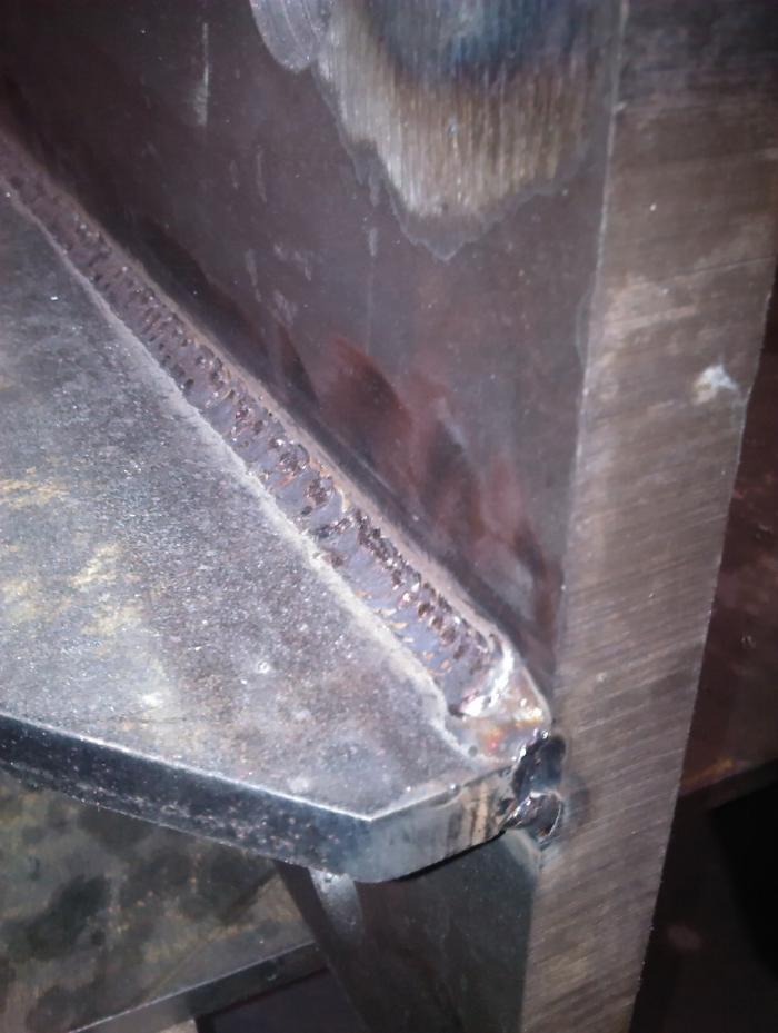

As I sit here looking at the failed UT reports, examining a macro and cussing the engineer (before offending any engineers, I am an engineer). 2" thick carbon steel plates, V-Groove, CJP (Complete Joint Penetration) with pre-heat and back gouging, etc.
This is why we are gouging tomorrow.....
The bevel was steep, but still manageable. Wire welding will let you deposit as long as you hold the trigger down. What has happened was the root pass was perfect, back gouged perfectly, filled all the way out, root pass cracks. Hell, the welds even looked good, right out of a text book.
Weld bead GEOMETRY!!!!!!! We shot so much wire down the gap (because we could) we produced a very tall but tapering thin weld bead profile at the root . As we filled and heated, the stress cracked the root.
Wire welding is a fantastic production tool, but in the unskilled operators hands or bonehead engineering procedure, could lead to catastrophic failure and in this particular case, unimaginable failure.
Procedure has been changed to a 8018 root with FCAW fill and cap. Wire is fine, but there is a reason when it comes down to the brass tacks why GTAW and SMAW are the preferred processes in my opinion.

Success, over a total of 80 linear foot of 1-1/4" plate T joint to 2-1/2" plate. CJP (complete joint penetration) with 8018 SMAW root and Dual Shield FCAW fill and cap. 100% UT inspection and passed.

Interesting. Over here it is routine to weld heavy plate with mig all the way, even to UT, X-Ray or pressure standards.
Full penetration welding on heavy plate primarily relies upon adequate clearance to get the nozzle in close, adequate root gap (if specified) and appropriate preheating. Followed by back gouging the root (preferably carbon arc) and dye penetrant testing. Not to mention correct welder settings as well.
Most mig welding done this way routinely pass tests. Root run failures happen for many reasons, one of the biggest would be too tight a weld prep. I suspect a lot of this would be from the joint being too tight and the welder needs to increase the stickout to get his angle right. Result is voltage drop at the arc and potential inadequate gas shielding.
Most high level structural and mining specs call for flux cored wires with argon mixes. CO2 shielding is used here and there, but its use doesn't seem to be as common any more. Even 6G tests are done with flux cored root runs.
I was running a night shift some years ago building Marion Dresser draglines for our mines. All positional welding was done with Verticor 3xp and flat welding was Fluxofil 11ni. Long flat runs were submerged arc. Almost all failures were simply visual minor finish defects which were fixed within a few minutes. Most of the guys performed some astonishingly good finish levels.
Incidentally, our weld procedure prohibited SMAW.

You nailed it, exactly correct bevel to steep, to tight, to much stick out and fill.
