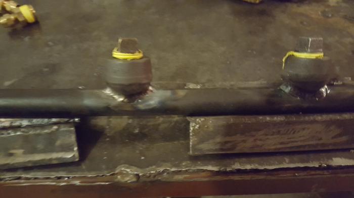

Evening,
The reason I'm trying to weld on black steel is to fix a propane burner on to a Green Chile roaster. My plan is to cradle it on a piece of angle iron and weld in place on the tee's because that would be the only point of contact and also weld a piece of tube around the orifice so that air can be drawn from behind the orifice too. Judging by the name it sounds like it has a high carbon content.

The "black" part of the name is a description of the surface cover only, not metallurgical or anything. The black is paint (or something) to prevent rust. Clean down to shiny bare metal before welding and you should be good to go.
Dave
aka "RTFM"
aka "RTFM"
If those are threaded tees then I would recommend not welding them. If you want to weld it get some socket weld fittings. There designed for this and will give you a better result.
It is regular mild steel but has some kind of coating plus a layer of varnish or lacquer on it. That coating must be removed or you will have a nightmare trying to weld it. It doesn't sound like you are welding the tees and pipes togther, only tacking the tees to an angle cradle so you should be ok. It welds fine with the coating stripped off.

I looked into the socket weld fittings and found the right one.
- 20160408_211713.jpg (26.69 KiB) Viewed 824 times
That looks better. Another good option if your going to weld it is any of the forged steel fittings. You can get a half coupling that will save you just a little space over thread-olets.
It sounds as if you want a method of attachment as well?
There are several pipe standoff's on the market that would look very professional - or copy/modify a style that works better for you.
