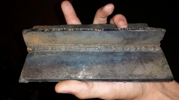

I am using a 6010 for the root pass on both the t-joint and the open root. I tend to have the best results using a whip and pause motion, I will take some pics of my work today and share with you guys.

Here is my t joint & v groove without backing that I was passed on monday
- V groove cover pass, I know it is an ugly one

Looks like your T joint images are two of the root pass. Minor detail.
I'm no welding veteran so this here is just my 2 cents contribution.
The uneven appearance on your welds seems more of a speed and position issue than anything else. Perhaps the initial root pass was over filled. When the cap was applied giving an overfull appearance. What angle do have the electrode for your vertial runs?
Perhaps a quicker pass with slight oscillation to flatten the bead and then use a slightly larger weave for the cap pass.

Root pass is required for everything we do in school, I do a lot of whip and pause in vertical with my 6010s. I have would without any motion that progresses forward a little it droops and sags to much. I thought I posted the cover pass, here it is:

Those vertical stringers look pretty good considering they don't look very nice in any case, hard to flatten the weld profile.

He is using 7018's though. What are the weld puddle properties like of your 6010's in comparison? The T joint vertical up root pass shows a single bead with a little oscillation to help flatten it out somewhat. The video pretty much sums up anything I could add.

My 2 pass and cover pass were run with 7018, is it common or better to use 7018 to run a root pass? I had some issues all semester with rod angle and travel speed but for the most part that is how my roots looked on a regular with a fee that were a little worse.
