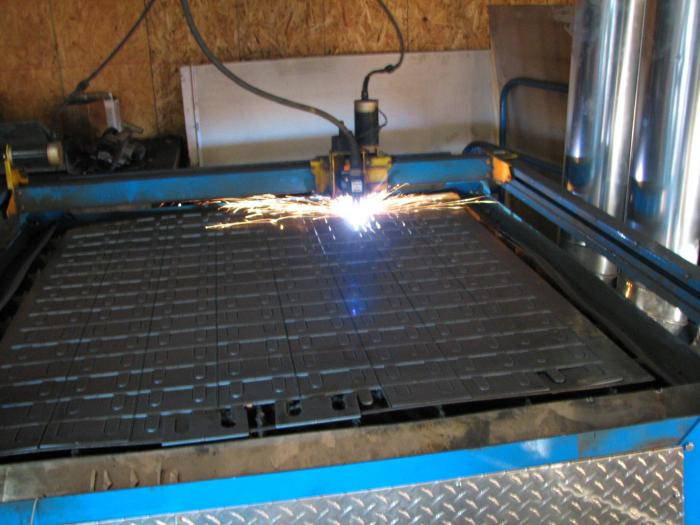

There are a lot of choices in the entry level CNC plasma table market....I count over 25 just from North America. The two biggest players with the most systems installed are Plasmacam and Torchmate. The most popular do it yourself type cnc plasma tables generally use electronics and software from www.candcnc.com .
I have a 2 Plasmacam tables, 2 x 2 and 4 x 4 as well as a 2 x 4 Torchmate. The Plasmacam 4 x 4 has been in my shop (currently has a Powermax85 plasma) for almost 10 years. Extremely reliable and it has paid for itself a few times over....even though I am mostly a hobby shop. The software is easy to learn, easy to use, and one of the most important features (on any cnc plasma), the height control is flawless. Now Plasmacam had two earlier models that had height controls that were problematic......so if you are looking at older machines beware!
Typical job on my machine. A local business needed 800 1/8" thick shim plates for a construction job.....their regular supplier said two weeks lead time.....they needed them in 2 days. I took the job, spend less than two hours cutting and cleared over $800.00. Push the button and go do something else in the shop.....come back when the machine stops.
Jim Colt
Jim Colt
- shim job 004.jpg (51.59 KiB) Viewed 2596 times
