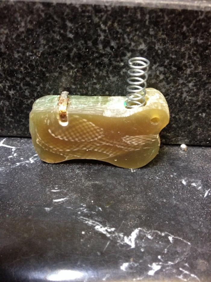

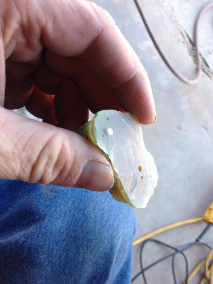

The trigger on my old Hobart Handler 150 broke and I couldn't find a new one since that model is discontinued. I first made a new wooden one but it soon broke too. Not sure if parts are available, but here's my solution. I used modeling clay for a mold and made one from fiberglass.

Very cleaver!
Nice, but what about this? http://www.airgas.com/product/Welding-P ... /BER177488

I like it - never thought about using fiberglass for little parts before.
I've made parts this way for other things in the past. Modeling clay makes a quick and easy mold. Just make it a little oversize and sand to final shape. It is a bit messy. I learned from experience that the kitchen table is a bad place for such projects

Interesting. It was about a year ago when I tried to buy a new switch and my Airgas dealer wasn't able to find one for my machine. He said the company changed torch styles somewhere along the line and the first model was not supported. Shrug. I got it fixed anywayGlenC wrote:Nice, but what about this? http://www.airgas.com/product/Welding-P ... /BER177488
