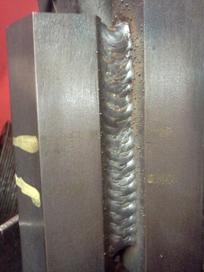

Is that basically like a leak down test? Here is today attempts at vert up mig .035 solid wire 18.5 225 230. Wfs I gotta get this licked lol it's bugging me
bottom pic was first attempt upper was last everybody at work is like why the hell are you working on your breaks lol

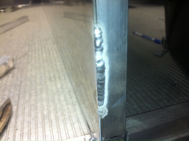

Well today I was welding on some .100 3003 alum and was thinking about the thread a while back on fusing aluminum so I thought I would throw this up. This is fused to 1" x 1/8" square tube. I don't know the amps.
I also have a question for everyone. Why did I have a problem with porosity on these fuse welds? This was the best one, but the others looked bad. They will hold but I had quite a bit of porosity.
Oh and don't touch your filler wire to your wrist....it hurts.
Looks nice again. If I recall, the highest my welds have been tested is 5000psi. 9600 is quite a jump!

JDIGGS82,
I see quite an improvement. Some suggestions for you. try to hold a tighter weave and see how you like that. It may not be your "thing" though. Also you can try to hold the sides just a half a second more. These are only suggestions, you are doing great without my help.
I think you are close on the settings, though there is quite a bit of spatter. Maybe to much angle? I will try to give it a go tomorrow so you have a better idea of settings. Are you using 75/25?
Will do!
