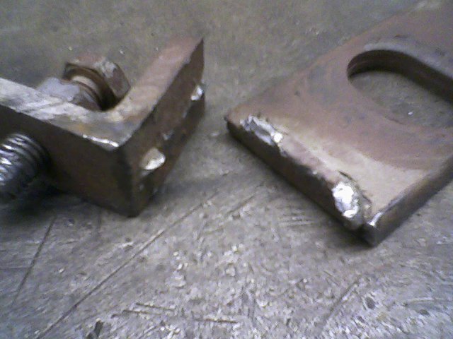

this weld has been in service for at least 30 years. it's part of a locking device that opens and closes a cell door. it looks like a mig weld and has no penetration but was still strong enough to have cycled thousands of times till tonight. repairing this is job #1 for the morning.

It looks like a cold weld, I have a few blokes where I work that refuse to crank up the amps, their welds resemble chicken shit, but going by your pic, chicken shit holds......

not only cold but maybe stainless steel also. i'll find out later this am when i grind it off.
