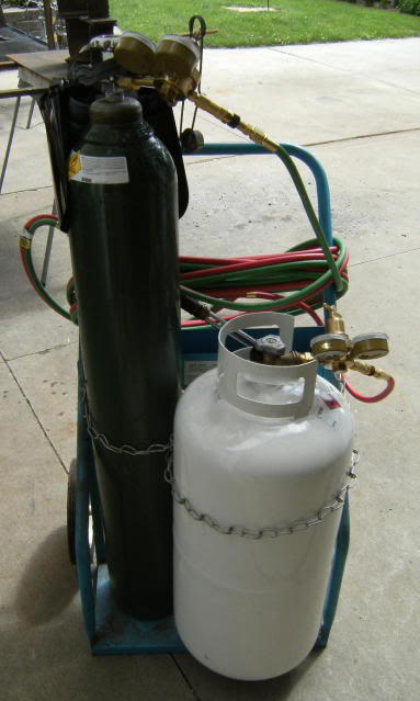

I would rather buy used tanks but dont know what is a good price for decent size tanks.on craigslist in my area someone wants $175 for just a oxy tank and hose and there is another for the same price but they are baby tanks of oxy and ascetaline.
looking for something around thi size in the pic.
Thanks - Peter.
That pic appears to be oxy-propane (which is an affordable route, due to the wide availability of propane).
A similar capacity acetylene bottle is larger, because acetylene is stored dissolved in acetone (because above 15 PSI it can break down and spontaneously combust).
I suppose that does nothing to answer your question. Be aware that every bottle out there has a certification date stamped on it. If the most recent date has a "+" after it, the certification is good for five years from that date. If it has a "+*" (plus-star), it's valid for ten years from the date. Once the five- or ten- year certification expires, no reputable company will fill it until it is recertified. This is the value in leased bottles... The recertification is the responsibility of the lessor, and you simply exchange an empty bottle for a full one, no waiting.
