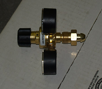

now, whats wrong with this one?
We recently bought a new regulator (a cheapie Radnor 601-AR) which drained a full 40cu argon tank in less than a day. so we returned it for another.
- regulator.jpg (52.27 KiB) Viewed 2889 times

Obviously Radnor doesnt have very picky QC personnel, that is if there even is a QC line at all!
Definitely check it next trip back, might save ya future frustrations.
Actually, you should be able to just unscrew the male connectors shaft from the meter's body and flip it around yourself.
Save gas in the process.
yeah, we got it all squared away. it was airgas's bottle that was the problem with the first one, so they sent our first regulator back out. no leaks. I though the picture was pretty funny though.
