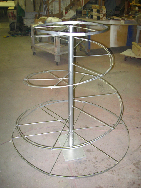

Every year our shop participates in The Festival of Trees in Detroit which is a showcase of trees designed and decorated by professional designers, florists, decorators and us, carpenters and welders. The festival is a fundraiser for Childrens Hospital of Michigan. All the trees and labor and supplies are donated by the participants. The trees are auctioned off to the highest bidder and the proceeds go to the hospital.
This past year, I decided to build my own tree out of aluminium. The theme for the tree was The 12 Day's of Christmas. The whole frame of the tree was built and welded out of 1" and 1/2 tube, 1/8th rod ,1/8" flat stock and 1/4"plate . The tree was over 8 foot tall so it had to be built in 2 sections to fit in my van. The tree is 4' wide at the bottom and tapers in to 6" at the top. It also spirals up.

- both halves together
- tree4.jpg (221.37 KiB) Viewed 1700 times

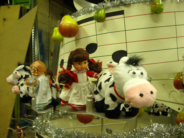

You can only post 3 pictures at a time so here are some more. I also had to make some bases for the "maids a milking" so I cut out a plywood template and used a plasma cutter to cut the bases out of plate.
I also used a planetary ring roller to roll the flat stock and to try to get the taper in the rod. If I had to do it all over again, I would have annealed the rod because it was a huge pain in the a$$ to taper it smoothly.

- plasma cut bases
- tree11.jpg (222.74 KiB) Viewed 1699 times
