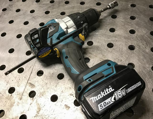

What are you using to run it? Pics?tungstendipper wrote:I like mine!Goldhawg wrote:I was considering the one from certiflat
https://weldtables.com/products/fabturn ... e-everyman
- tungstendipper

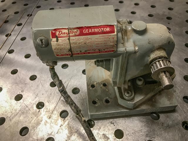

I use my cordless drill with a 7/16" socket and an extension. I also found using this clamp helped regulate the speed a bit more consistently. I could set the speed using the squeeze clamp, then once the speed was found slide it off and slide it back on to remember the same speed setting.
The last photo is the permanent gear box and motor I will use to power the positioner, along with a rheostat to control the speed.
