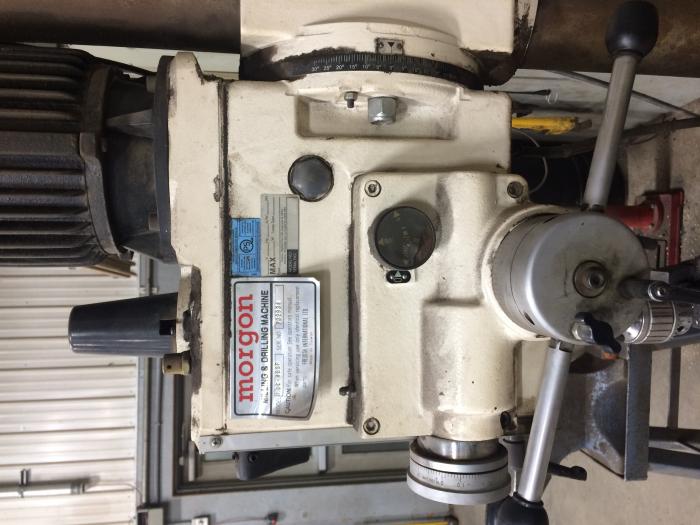

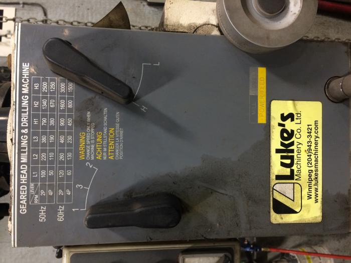

I know this is a welding forum but are there any machinists in the crowd? I have a heavy duty drill press in my shop and it seems like I should be able to do some milling with it. Just basic stuff at least, key ways in drive shafts, slotted bolt holes etc. The press has 6 speeds, power down feed, forward/reverse. And it does say Mill/Drill on it so me thinks I should be able to do the above. What would I need to get in order to be able to? Cross feed table I assume, and also what basic bits would i need to get started?

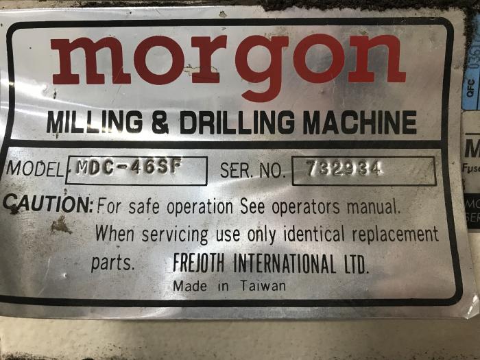

That is half a milling machine, as it lacks the cross feed table. But as a drill , it's great. You won't get better. Well it's not an Swedish Arborga , the worlds best, but I would bet it's a Taiwanese Rong Fu. Also a high quality gearhead.

Are there cross feed tables available to add onto something like this? A good quality one, nothing flimsy. Where would I look?Downwindtracker2 wrote:That is half a milling machine, as it lacks the cross feed table. But as a drill , it's great. You won't get better. Well it's not an Swedish Arborga , the worlds best, but I would bet it's a Taiwanese Rong Fu. Also a high quality gearhead.
Good guess by the way!!Downwindtracker2 wrote:That is half a milling machine, as it lacks the cross feed table. But as a drill , it's great. You won't get better. Well it's not an Swedish Arborga , the worlds best, but I would bet it's a Taiwanese Rong Fu. Also a high quality gearhead.

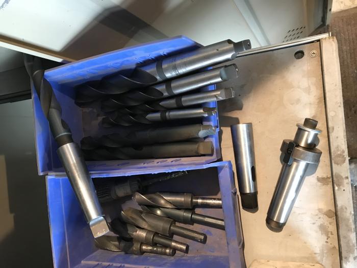

From the drill bits you have, it looks like it has an Morse Taper #3 ??, quil. Great for drilling ,but harder to find collets for holding end mills. They are available, though. The R-8 taper is more less the standard.
What twigged me to it being a Rong Fu is the grey paint on the face. It's the same shade of grey as my Advance RF-45 mill/drill. The RF stands for Rong Fu, the Advance is just a house brand.
