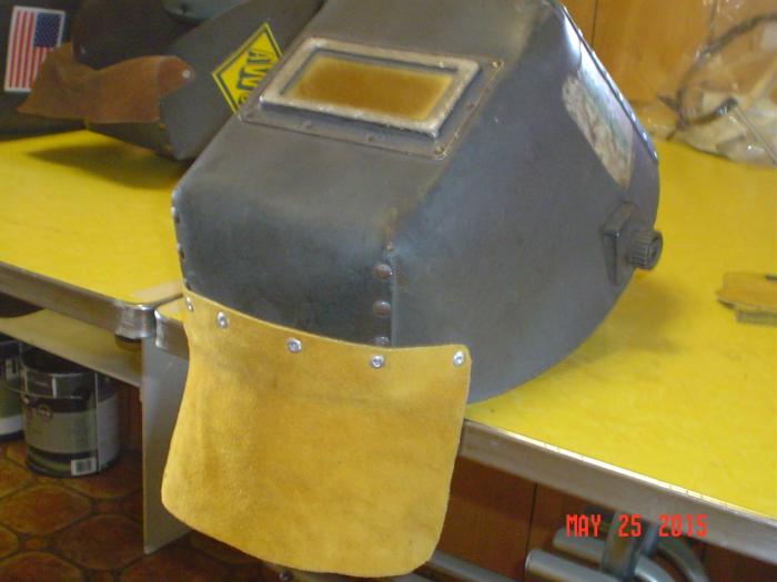

Tillman makes a leather bib for adding to a hood (part #566). I don't like the metal attachment clips they come with so I pop rivet mine on. Never tried attaching them with Velcro but don't think it would hold up in the long run. In general you want it on there securely so it stays in place and you don't end up fighting with it.
- welding hoods 3 002.JPG (35.96 KiB) Viewed 1416 times
Farmwelding
- Farmwelding
Location:Wisconsin
Velcro did not hold up very long with mine once I really started using it every day. Part of that I'm sure was drastic temperature changes from a lot of cold outside to all of a sudden welding in the warm shop.
