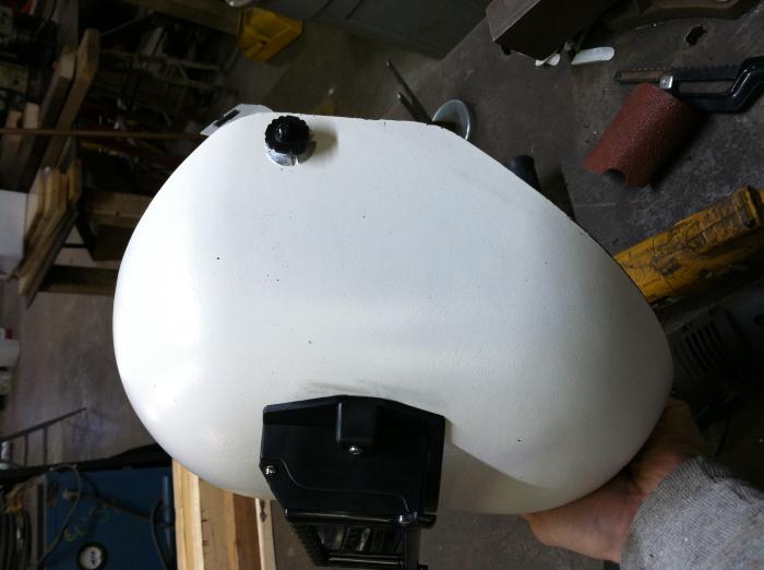

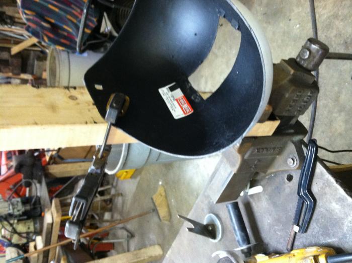

If you're planning to modify a pipeliner hood here's a way to hold the thing steady with a 2x4 in a vise. I recommend marking the left to right centerline before cutting out the lens holder also-there's not much to measure from once the lens holder is gone.
